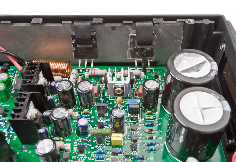

Here is a picture of the replacement of the 909, the QSP, sporting tiny modern devices. The amp costs 25% more and is less powerful. It seems to have driven the price of used 909s through the roof.

Your set-up is very cool. The clips Quad is using in the newer amp to hold the power transistors to the heat sink is not cool, no pun intended. They look like the same clips used to hold some automotive mud flaps in place. Ugh.
I know it looks really tatty. Peter has been dead for a number of years now. The 909 had his definite stamp on it. I have been careful to buy older used models made in Huntingdon. The Chinese factory have apparently caused a buzz by not building the ground plane correctly.
