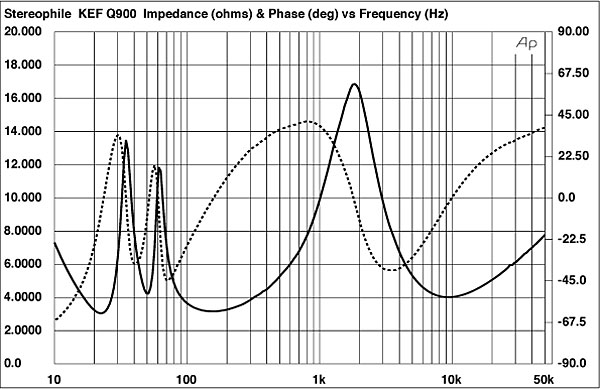

You will want something better than a lower end Onkyo to power the Q900s. Here is the impedance chart for the Q900s:
Sell your Onkyo and get a receiver that can either handle 4 Ohm speakers or a receiver that has pre-outs for separate amps. You might look at the Emotiva UPA amplifiers.
Sorry, but since I am just a newbie for stereo equipment, I do not know how to read the chart in comparison a receiver that may handle fully Q900s. What are options do I have in terms of AV receiver that can handle 4 ohm speakers, or which separates should I consider within $1000.00 budget.

For under $1k, the only thing that I can think of which would be solid with a 4 Ohm load would be something like an Emotiva UPA-500 plus a receiver with pre-outs like this Onkyo 717. There may be better solutions, but that ought to work.
