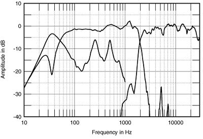

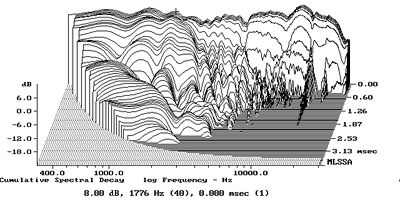

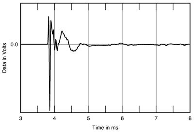

I have never seen a circuit for one, but I have had a long curiosity about them. He used what he called Cuadra filters, and patented them. They have 100 db per octave slopes. I have seen measurements of those speakers, and there is a lot of ringing at the crossover regions, as I think you would expect. So probably not a good idea.
The time smear is enormous.
The ringing at crossover is monstrous.
Which all goes to show, that an FR plot is not the whole story.

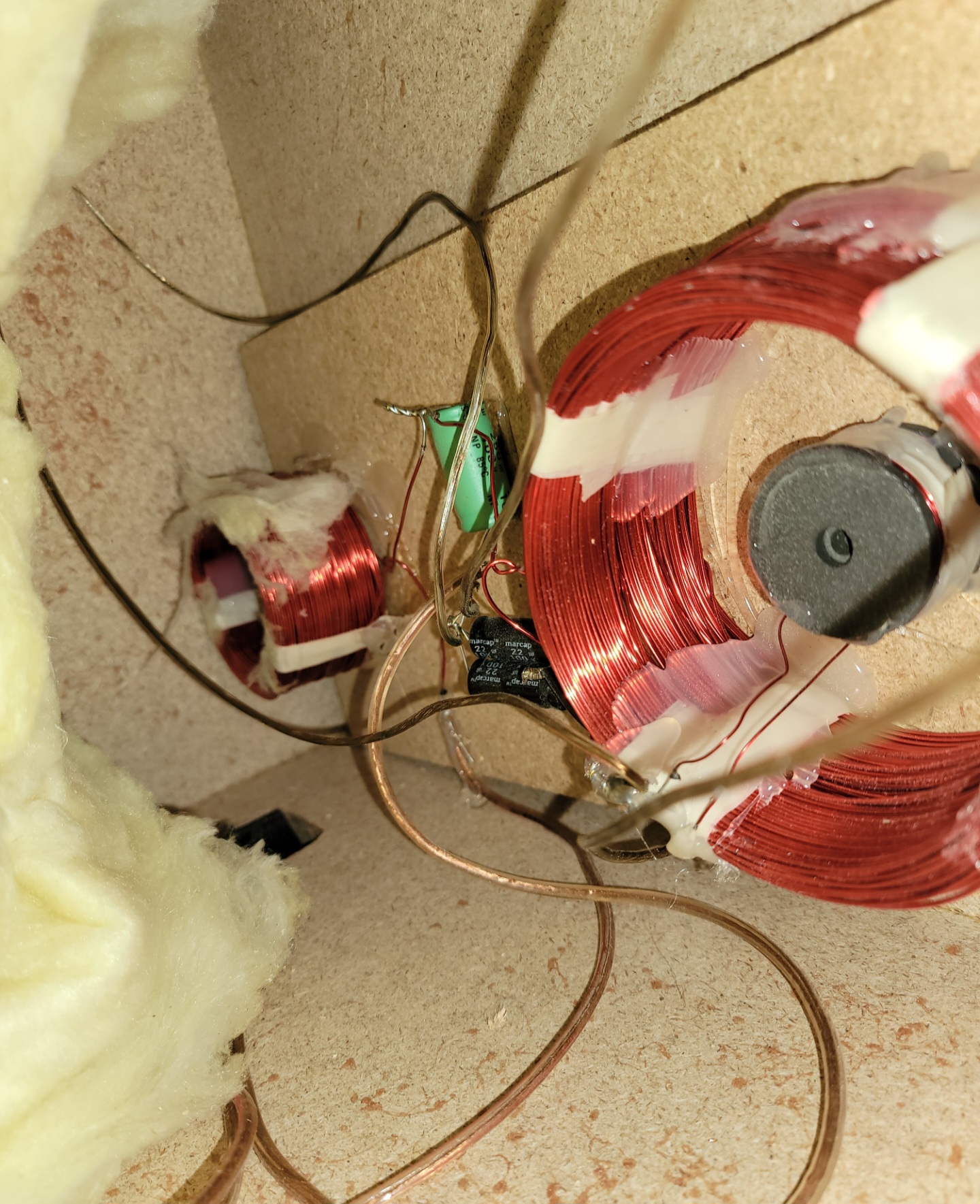

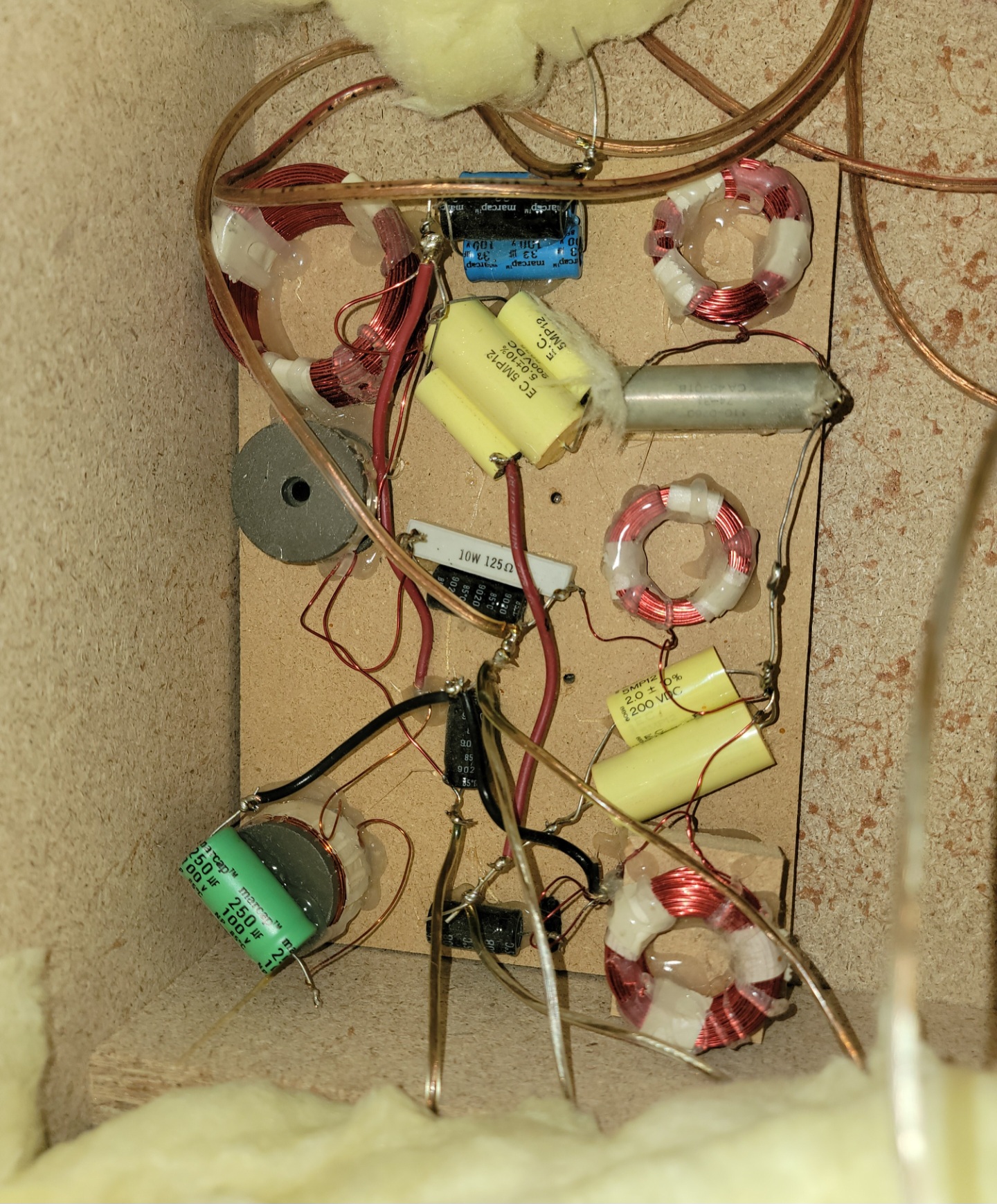

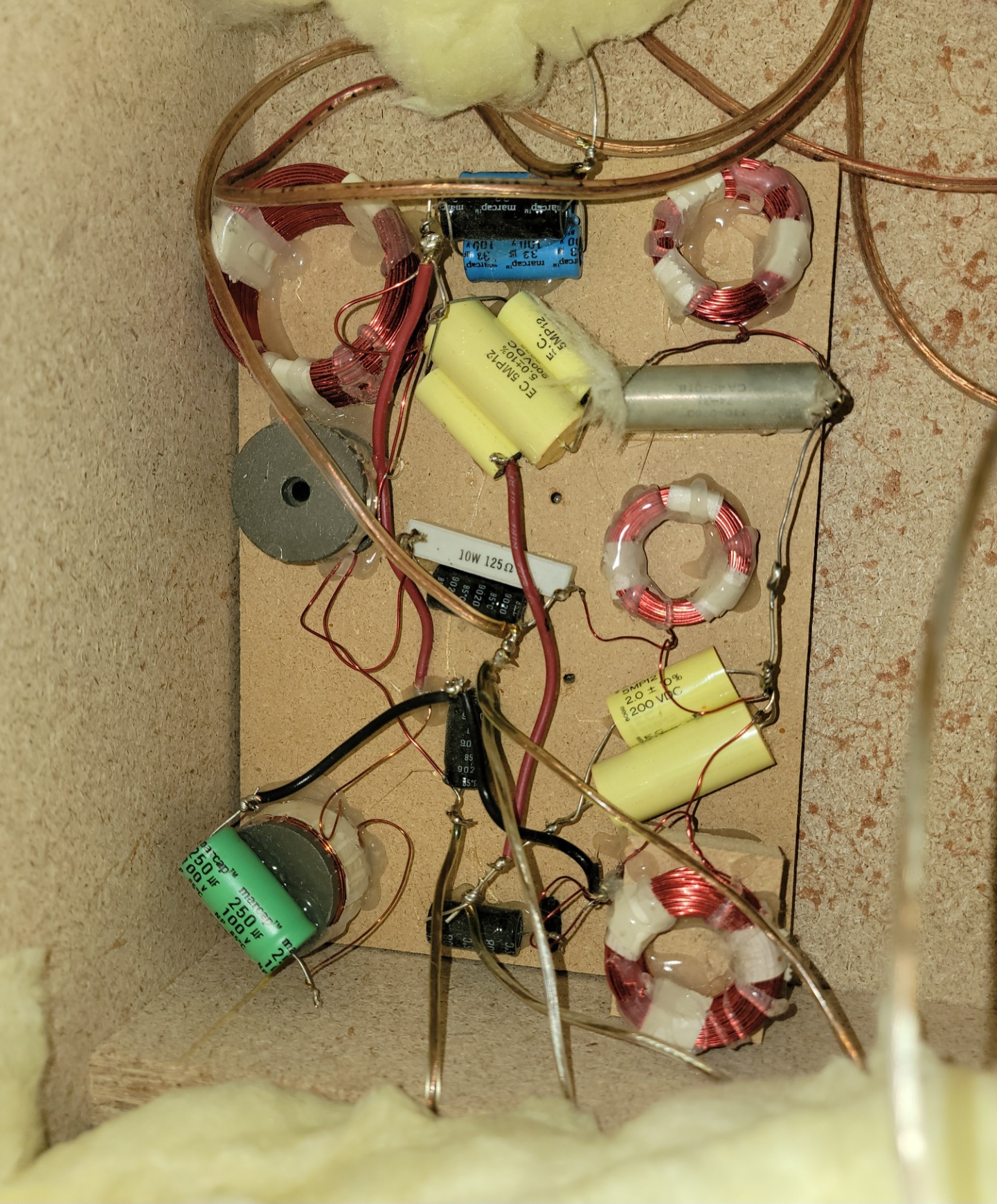

I apologize for the delay in sending the pictures of the crossover. Kids, sports, work and fear of messing something up. Lol. I want to be proactive and maintain anything that could affect the speakers performance.
View attachment 65827View attachment 65828
I reckon that bloke must have been a sparrowhawk in another life, to create that untidy bird's nest.
I just would not consider touching that mess.
The problem is that chap never explained that crossover, and according to Dennis locations and distances of the inductors are part of the design.
Now crossovers seldom give trouble due to age. However electrolytic caps can wander with time. That crossover has 10 electrolytic caps by my count.
However, anyone with an ounce of sense is not going to go near that crossover.
That is just a frightful amateurish looking mess, and I could dredge up more colorful expletives.

C
chucksrt
This is how I build my crossovers, and I do not use electrolytic caps, and don't have to worry about rebuilding ever.
It's definitely not as well thought out as yours is. I guess I may have to contact Joseph Audio to see if they have recommendations for my units.
