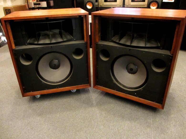

The sensitivity is 97.5 db 1 watt 1 meter. A 10 to 15 watt amp will drive these speakers to deafening levels. These are the speakers. They are form the 70s and were a consumer speaker using the Altec Voice of the theater components, that were widely used in cinemas across the world.
They used 15" drivers and crossed to the compression driver loaded by large sectoral horns at 800 Hz.
If memory serves me correctly the f3 was in the low forties. The drivers were low Q types and the bass very punchy, with very articulate dialog.

TLS - those pictures represent my exact speakers. My home made cabs are identical. I have the plans right from Altec. (Back in 1974 when I bought the parts, my dad was an Altec dealer. I had all the parts delivered to our home just outside Toronto for $417.00 (Canadian) tax in!)
LovintheHD - my Denon has an LFE + main selection. I used it in the past but didn't notice any great advantage. Based on everyone's comments, I suspect I had my sub crossed too high (90 Hz). Sounds like I should try the LFE + main setting and cross the sub around 60 Hz. I have never known the true F3 of these cabs. TLS says it's in the low 40s. I'll give this a try today and post back.
