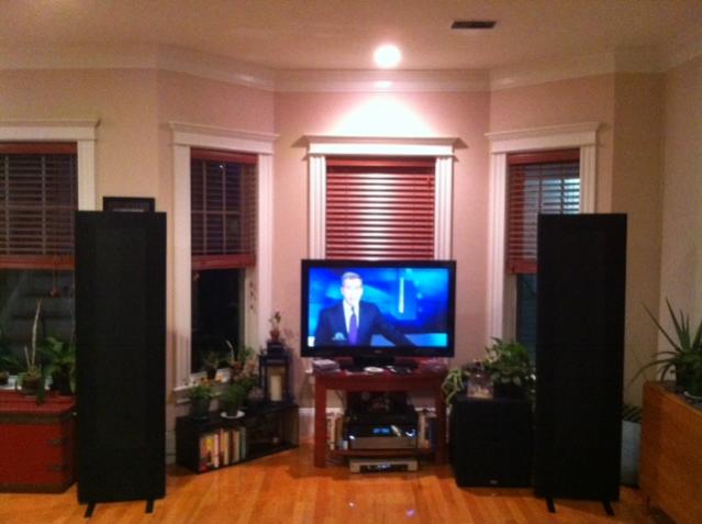

So I actually ended up getting the Rythnmik f15HP. Does anyone run dual subs that are closely located? I am thinking about adding another but the only place for it would be a few feet away from the other. I have attached a pic. The SVS is set up to the right of the tv, where the rythmik will go, and i am thinking or another one to the left of the tv. I can only EQ on the sub as my receiver does not have eq capabilities. Thanks!

After a little more playing I got the PB12nsd to sound quite good! I also just went and looked at the data from the reviews of the PB12 and the Ultra and my mind is made up to purchase the Ultra.
Hmm, I didn't know Rythmik made an Ultra F15HP. Is that a new model? :p
The F15HP looks like a very nice unit. Are you finding one isn't sufficient? It would seem as though you haven't had enough time to break it in yet, so it might not be a bad idea to wait a little and see how it does. Unless, of course, you just want duals. If that's the case then I'm certain Rythmik would love to assist you... ;)
J
Jeff R.
I am not sure how successful you will be without being able to crossover your fronts to your sub with the HK Recieiver I have that receiver and prefered having a receiver that gave that functionality.... It may take some time to get right.
