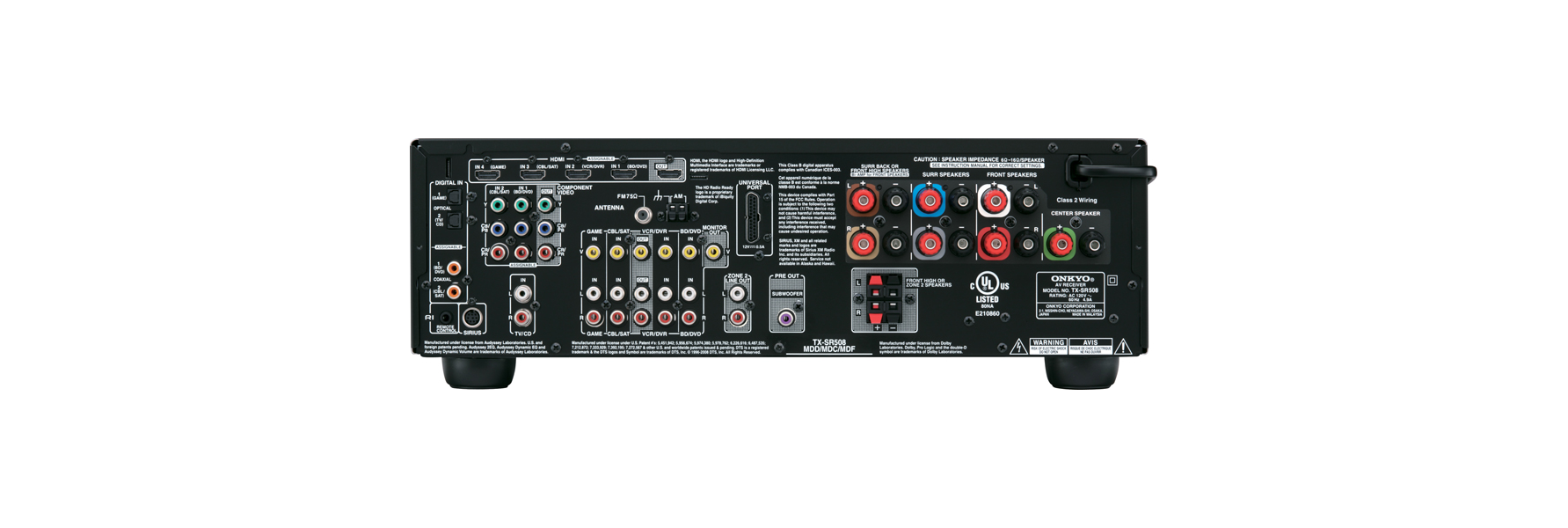

Possible silly question - will that $200 Onkyo receiver - or any decent receiver - have an adjustable crossover? My old receiver I do not recall having that feature, but maybe I was not looking in the right places.
Lastly, how can I plug my PC into this receiver? My video card has an HDMI output, but I have heard these are unreliable at times for audio and want to be able to plug it into my motherboard/sound card. It looks like THIS. HERE is the receiver.
Thanks for all your help, guys

Is this same ports as your motherboard? If so it have optical spd/if port is the one you should use. Next best would be HDMI port on your motherboard or gpu (it depends and hopefully it's ati card)

Yes, that is my motherboard. Holy smokes I did not see that optical port there! That is ideal. I have a GTX 460 graphics card, which has 1 HMDI output on it - not optical out.
Looks like I have to pony up for a decent receiver with an optical port. So, again, do these receivers have the built in crossovers and are they adjustable?
Onkyo TX-SR508 has 8 steps Crossover adjustment from 40Hz to 200Hz - not as good as higher models - adjusted to 1 hz (like my TX-SR805), but its fine
Check out the manual page 35
http://filedepot.onkyousa.com/Files/own_manuals/SN29400388_TX-SR508_En_web.pdf?CFID=1705343&CFTOKEN=55544151&jsessionid=f0306499e55a69f044952c3c1a617514e791
p.s: 508 does have two optical inputs..
