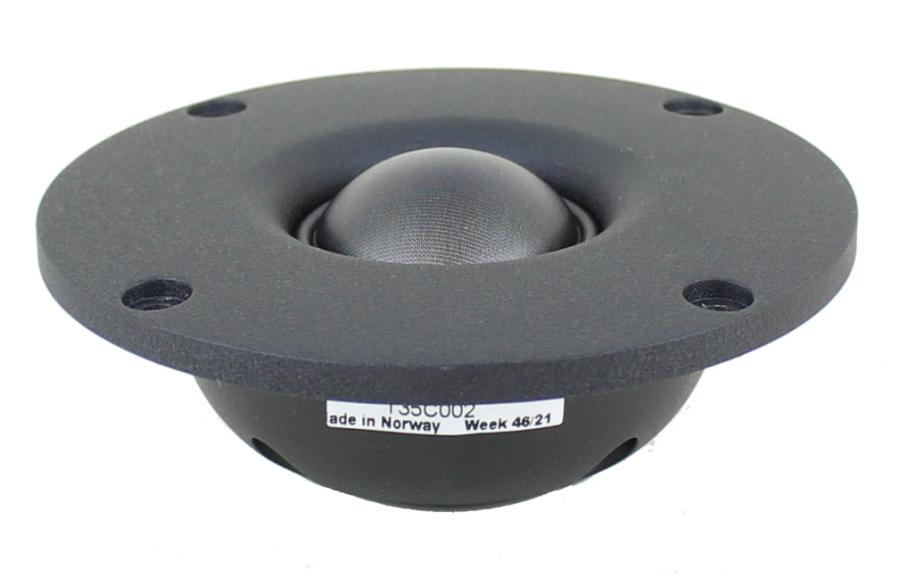

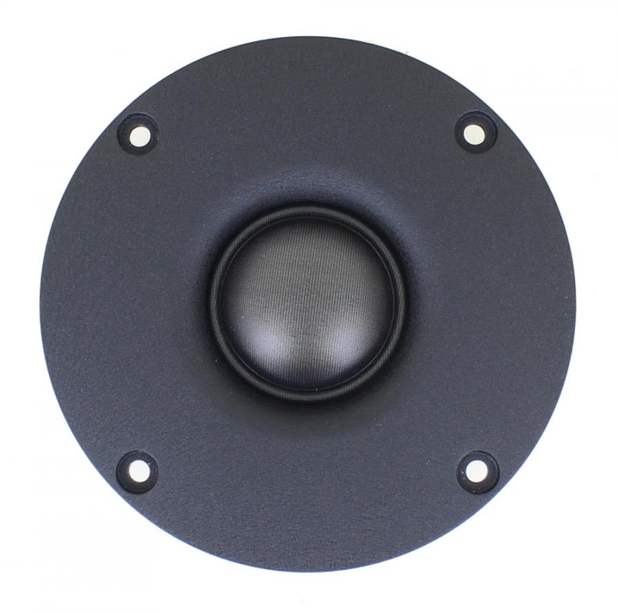

I do have a solution for you. I was looking at the pictures and recognized the tweeter as the old SEAS H-087 35 mm tweeter. This was used by AR and Dynaco and others. The old tweeters are failing. However SEAS have introduced a replacement I find, because of demand. Since this is specialist the price is a little high.
You will need to replace both, so it will set you back $504.80 plus shipping.
For those speakers, I would say it was worth it.
The sensitivity is 1 db higher then the original, but that is not enough to warrant messing with the crossover.
This is getting confusing. The OP says it's the top tweeter that isn't working. That wouldn't be the 1.5" Seas unit--it looks to me like the 3/4" "fried egg" tweeter that was proprietary to Allison. Maybe we're looking at different pictures. Can you vector me to what you're referencing? Thanks.
BoredSysAdmin
BoredSysAdmin
http://www.classicspeakerpages.net/library/allison/allison_cd_series/allison_cd_9_manual/allison_cd_9_manual_pg4.html#previous-photo
Spec in Manual says tweeter is 1" diam. Convex Diaphragm; 1/2" diam voice coil with silicone damping/cooling material in the gap, so it's not this 35mm Seas tweeter.
Two xover points at 350 and 3750hz
So, it's somewhat unlikely to be this 35mm Seas tweeter as drop-in replacement

Thanks bored dude. It's definitely a proprietary tweeter, not the 1.5" used most famously on the original Dynaco A-25. Michael--where are you located?
Dennis Murphy
According to that, the tweeter is proprietary. So the working tweeter would have to be measured. There are an enormous number of 1" dome tweeters out there, so finding a very close match is highly probable.
