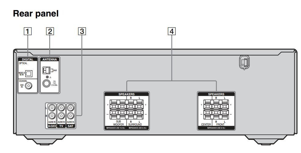

Is this what the back of your Sony receiver looks like? If so, you don't have 5.1 analog inputs, so you used a 3.5mm to stereo RCA cable - correct? A couple of things come to mind in addition to what Ponzio said, so I have some comments/questions:
1. Windows should be set up for stereo output.
2. How many audio output plugs does your computer have? If you have three 3.5mm output jacks, for example, only one of those is for front left/right stereo output. The other two are for left/right surround sound and center channel/sub output. So, if you have three and pick the wrong one, it's entirely possible that you are hearing the center channel output through the left speaker.
3. You say that the other speakers are quiet. Is the Sony in a surround sound mode? With only stereo output from the computer, you wouldn't hear anything except from the front left/right speakers unless you use a surround sound mode.

The back of my receiver looks just like the picture except only one plug for subwoofer instead of two. Doesn't matter how i "configure" my speakers in windows from the computer: stereo, quadraphonic, surround, 5.1 surround, etc. i still only hear it from left speaker. I double checked some settings on the receiver and all speakers get the same audio when testing them so the receiver seems to be working correctly to all speakers.
the cable i'm using between the computer and receiver is actually 3.5mm to 3.5mm but the one end has a 3.5mm female to rca stereo splitter.

Have you tried the SPDIF connection, yet? I recommend using that one. It can transfer 5.1 audio to your receiver.

well it's got both the toslink and the coax on both
Sweet - that makes it easy! You can use any RCA cable to connect the coax connectors. You might need to set up Windows to use that output. I had to do that years ago on Windows XP, but I don't know about 7.

Happy to help. I don't know why it isn't working right now. It could be an issue with the cable/splitter that you're using (maybe a bad connection somewhere), maybe the input that you're using on the Sony is faulty, maybe the jack on the computer is faulty, or something else. That does make me think of something - have you tried more than one of the inputs on the back on the Sony? Looks like you've got three sets of stereo analog inputs on the back. If you've only tried one of those, you could try a different one and see if it works.
You certainly can output a stereo signal from all speakers on your system. The issue is that you're only getting the front left sound. If you were getting both front left and right, then it would be some setting on your receiver. Just getting one channel, though, seems to be related to the connections.
