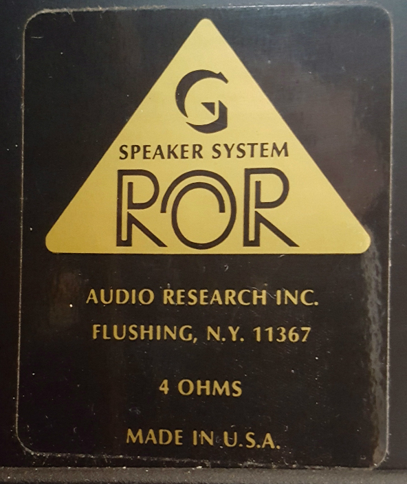

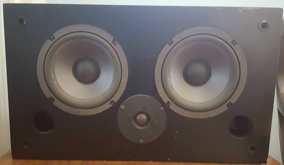

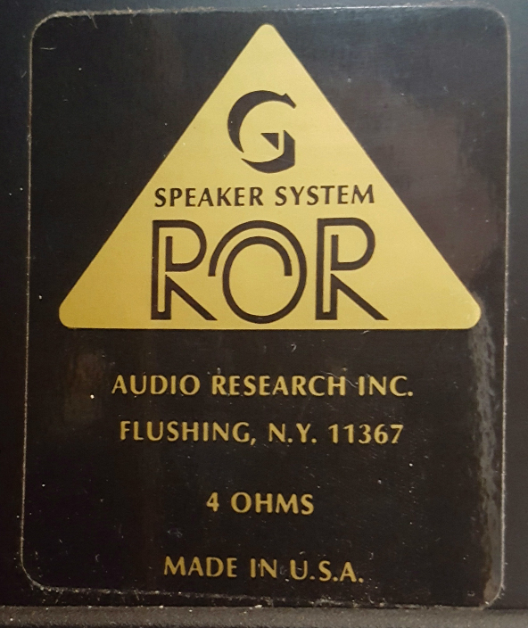

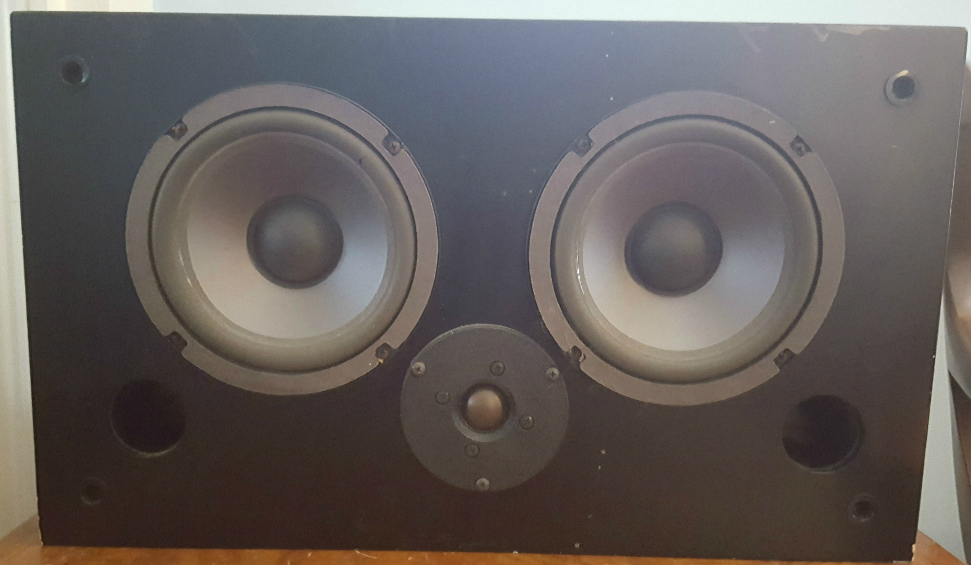

Thanks for the advise. Is this what you had?
R
RK-KY
The reconditioned speakers you mentioned that were your favorites, I remember those back from when I first started listening to music seriously back in the 70's if that's the same vintage. Those were/are actually pretty good. I don't know how long they kept making those after, or what vintage yours are, but if it's the same I'm thinking of, that's not a bad start for 2 channel, and 2.1 better yet.
That's kind of where I am coming from with my reply. I recently just revisited audio and am by no means an expert but I did manage to get some older JBL's to shine. I took the same speakers, hooked them up to a more modern Denon AVR and got even more out of them. The key being, I had newer equipment with comparable power ratings to the older amps that used to power the older speakers.
Larger spaces these days require a bit more learning. If that Integra receiver has a bass management feature, you're well on your way, I would think. The Denon I have is older but it does have some bass management features. I ended up using the pre-out section of the receiver to a separate amp for the subwoofer. There are options with DSP to EQ the subwoofer with that receiver if it does not have bass management.
I would read the (they are available online if you don't have them) manual and see what it mentions about subwoofers. At least that's where I started.
Below is the Bass management info from the Integra manual. I'm assuming I should set the speaker size to small. What Hz setting should I use?
Adjustable Crossover (80/100/120 Hz) for Bass Management
This setting allows you to set the crossover frequency for your
speaker system. This setting is valid when “Subwoofer” is set to
“Yes,” or for speakers that are set to “Small,” at the “Speaker
Config” menu. The crossover frequency is the minimum
frequency delivered to a speaker and can be set to 80 Hz, 100 Hz,
or 120 Hz. Frequencies below this are cut from speakers set to
“Small” and sent to the subwoofer (or to speakers set to
“Large”).
MrBoat
Start with 80. You can experiment with Large/Small, being as those are full range speakers to start with. They may well work on Large.
Also, research "mini DSP," or ask here after you try what you have first. I have just started to touch on mini DSP myself, but so far I don't need it. There will likely be some tuning options on the sub as well if it's an 'active' (with a built in plate amp) subwoofer.
MrBoat
View attachment 20090 View attachment 20091
I didn't own them but that's the same ones I listened to way back when. Those did sound great.
Do yourself a favor though. Don't start digging around some of the newer offerings that are meant to be paired with subs if you are really attached to those speakers. It will turn your expectations around, along with this 'sucking sound' near your pockets. Things have come a LONG way since then.
MrBoat
Check to see if your receiver is 4 ohm capable. I 'think' my Denon is. That may be your deciding factor.
