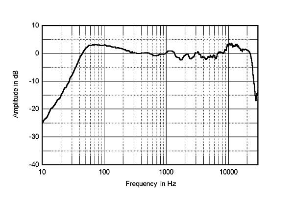

I have a1070, fronts - ProAc 148, Surrounds - ProAc 118, Subs - 2x Svs SB2000. I agree with what you said about staging and clarity. My concern is too much brightness with ypao and a too aggresive cut of the bass. I was playing with Flat, Natural and Through and always go to Through in the end. What i would like is to have something between Flat and Natural but with bass from No YPAO))) I have not triet to change the curve manually. Maybe this is what i should try?
I suspect as usual that your problem is speakers. Proac are known for a house sound often descried as lively or bright.
I did find a frequency response curve measured for those speakers.
The curve seems pretty typical for Proac, with the bass ripple for artificial warmth and the peaked HF at 10 KHz. A measurement from a Proac 100 was very similar. That curve would make a speaker sound a be a little bright.
Another reviewer compared the Proac Studio 118 with the ATC SCM 11. The Proac was described as lively and the ATC SCM 11 as subdued. Well I know the SCM 11 and its dead right. Billy Woodman is one of the best designers on the planet. If the Proac sounds significantly different from the ATC, then the Proac is wrong.
