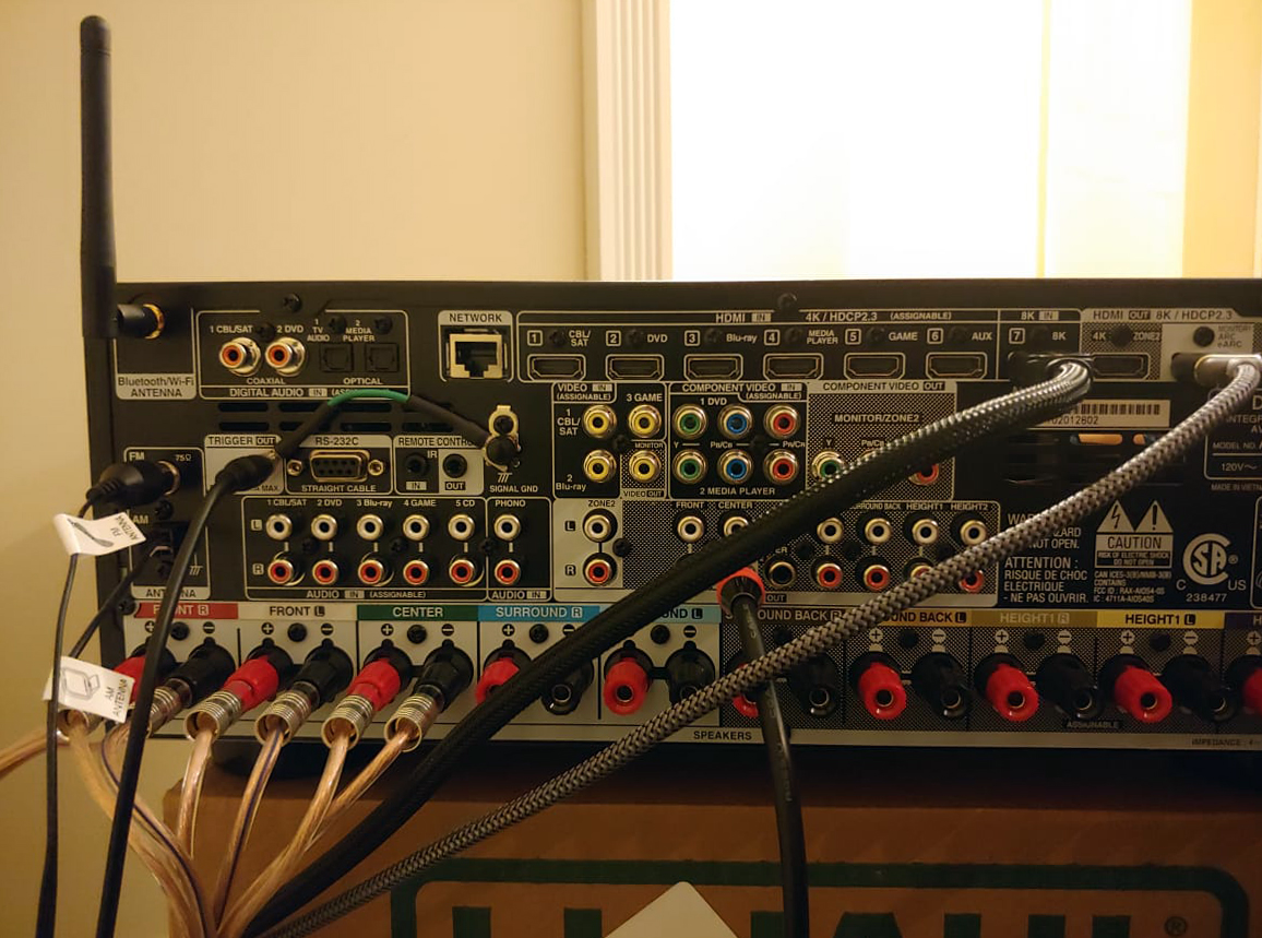

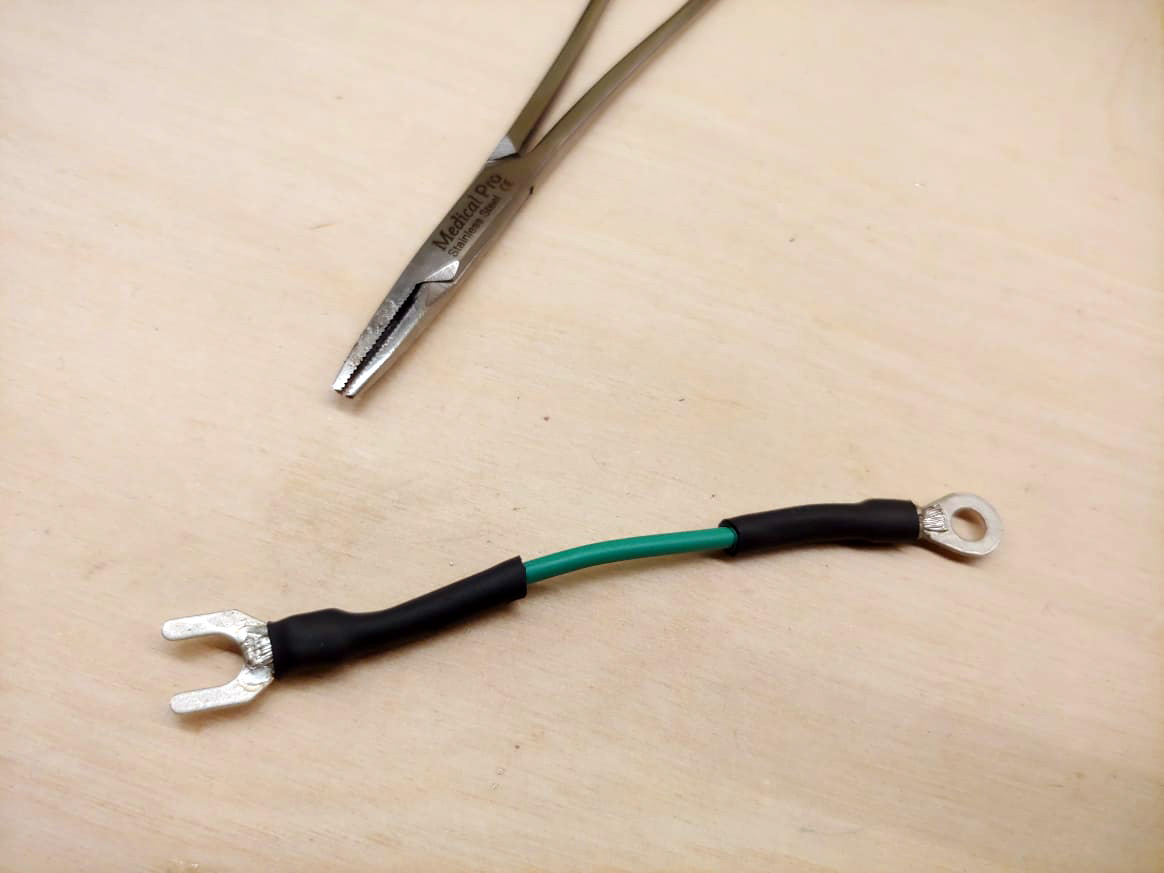

Old post bump... I just ran into this issue as well, but rather than chop up the trigger cable's braided shield, I merely added a short (3") ground wire between the trigger cable input on my receiver and its ground screw. The trigger cable input was isolated by a coloured plastic ring preventing contact between the subwoofer cable and the receiver, so they weren't sharing a common.
Thanks for posting this solution. I had the same issue with a Marantz SR6014. Your solution worked perfectly.
Another old thread follow-up. I have the same buzz triggering my Monolith amp from my Denon x3700h. I made the same cable but still have buzz. I missed the part about the plastic ring isolator.
Does this go under the ground connector (fork) on the Denon, the trigger out (ring connector) on the Denon or under the trigger in jack on the amp?
