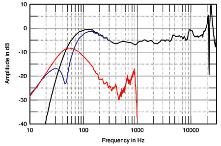

Now at 10kHz, it's +4dB, but that's not any worse than any of the B&W 800-Diamond speakers measured on Stereophile.

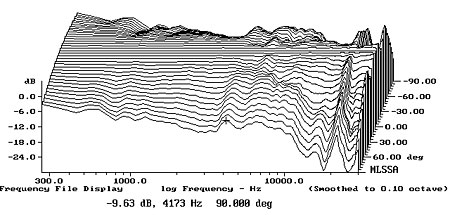

But it is worse, a lot worse. You can't just count db. There is a sharp peak break up mode in the Focal measurements. That is catastrophic cone break up and that tweeter will be an awful beamer. The OP is already becoming tuned into it.
The is the measurement I got on the B & W 800 D3. Not perfect, but it sounds like a really decent speakers. I have to say though I have no been fond of other members of that family, but that speaker is a very good speaker.
B & W 800 D3
Focal under discussion.
That speaker is just not acceptable. In fact if you look at the waterfall plot, that speakers is starting to get ragged above 3 KHz.
A speaker like that will start to drive you nuts fairly quickly.
B & W 800 D3

I highly doubt that. I stand by my measurements. Those speakers sounded a lot better then the 800 model he had before. Stereophile never measured those speakers, and I can't find anyone else who did. You are welcome to look for other measurements, but I can't find any. I used accepted techniques on tweeter axis at 1 meter, and carefully did the off axis measurements. I do know what I am doing and have been studying speakers for over half a century.

The D3 was a very different speaker. It was the first in the series not to use that Kevlar midrange, which was not very good. The midrange in the D3s is an excellent driver. Then in its successor, they messed it up basically reverting to an old fashioned spider center suspension. The idea and theory was to create less air resistance in the suspension. By others measurements it was a downgrade. Phil's previous 800 speaker was the D2. I did not like those much.

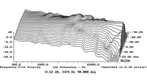

Here is the Stereophile measurement of the Diamond D3, which looks almost identical to the D1 and D2, like I already said. I just saw the D4 on Stereophile and it looks even worse. :D
Here is the new B&W 804 D4 and it looks the worst yet. :D
Stereophile has been very CONSISTENT with their measurements on the D1, D2, D3, D4.
Someone could measure these Focal speakers in their house, and it could look just as good as your personal measurement of the D3, even though Stereophile has shown that the D3 FR look just as bad as the D1, D2.
That Stereophile measurement is almost identical to mine and insignificantly different. Mine just is posted with a more expanded x-axis. Both show a rise at 10K, but it is not a sharp spike break up mode. Having said that, I am not someone who is fond of hard dome tweeters and personally prefer good soft dome ones.
Stereophile.
Mine.
If you expanded the stereophile x-axis they would look virtually identical.

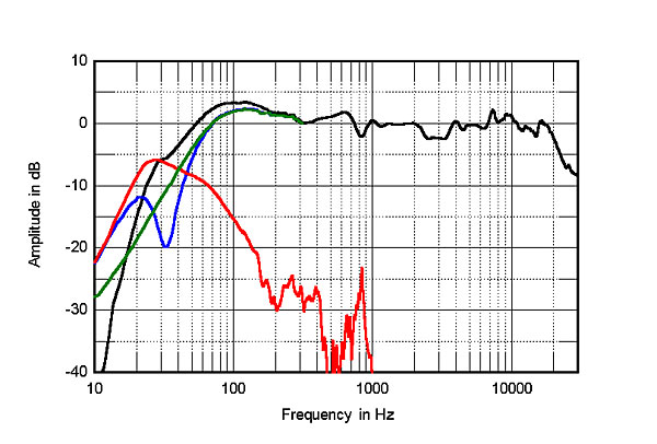

Here’s a REW measurement in my 17x12x8’ room
