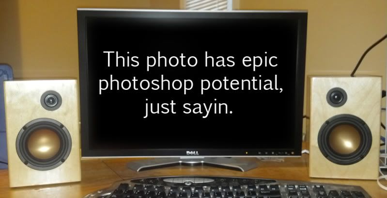

The first pair are complete. They're pretty vanilla looking, but I'm happy with the way the poly turned out. I'm far more impressed with the sound, though. These things sound MUCH bigger than their size would let on.
My wife came in the house when I was giving them their first test. She did a double take when she noticed I wasn't listening to my usual mains.
My apologies for the cell pics.
lsiberian
lsiberian
You might want to get that white spot cleaned up. :p
Nothing is quite like a pair you put blood, sweat and tears into.
