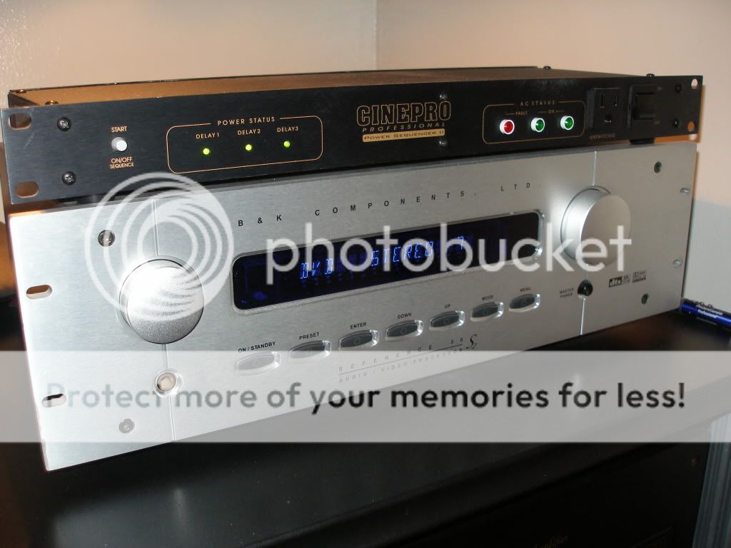

I use a power sequencer. One click everything is on.
