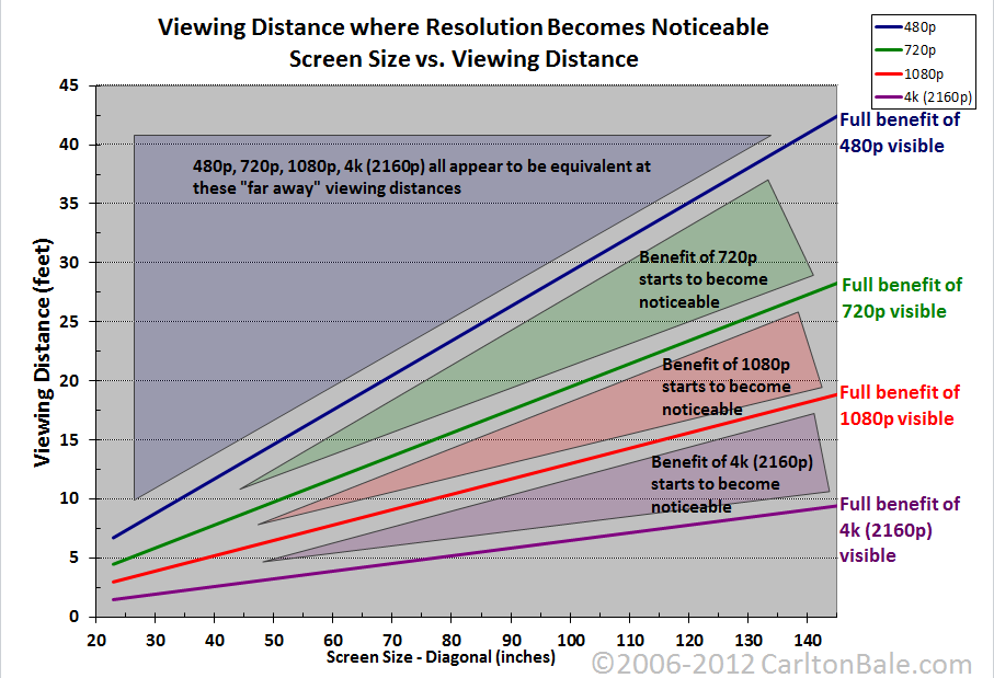

Another thing, yes, you would need a very large screen for 4k to make a big difference- and you would need to be sitting relatively close to it. I would rather have HDR than 4k.
As you can clearly see - assuming 10-12ft distance, the benefits of 4k/UHD will start to be visible even from "small" 90" diagonal screen and I plan to go with 120"+ screen then time comes for my basement HT.
