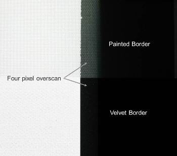

Not that it isn't tricky to do this, but there is a very specific reason to do this properly and to use those borders exactly as they are.
A 16:9 screen is perfectly rectangular. It has straight edges parallel with each other and is the proper shape and aspect ratio. If you aren't filling it properly, then it means that you aren't seeing a properly squared up image on the screen. If one side is to large, it means that one side is to large! During pans or people walking across the screen, they will get 'smaller' as they go from one side to the other.
It may take 30 minutes to align a good projector (like the 5020/8000) it may take longer if you are a new projector owner, but once it is setup, it will fit perfectly.
If you just use a painted white wall, you can paint black borders on it later, if you want to, and you can paint the borders to match the edges of the projected image.
No - as described above, this justifies not having a proper image instead of having a properly squared up image. As well, paint is not a velvet border which properly drowns out a bit of overspill. A good screen with velvet borders can handle you being off by half an inch and will still look awesome.
This is the difference between a painted border and a true velvet border:
