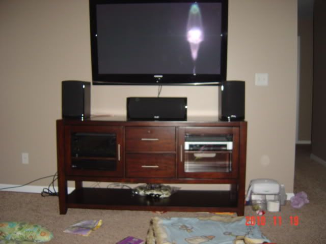

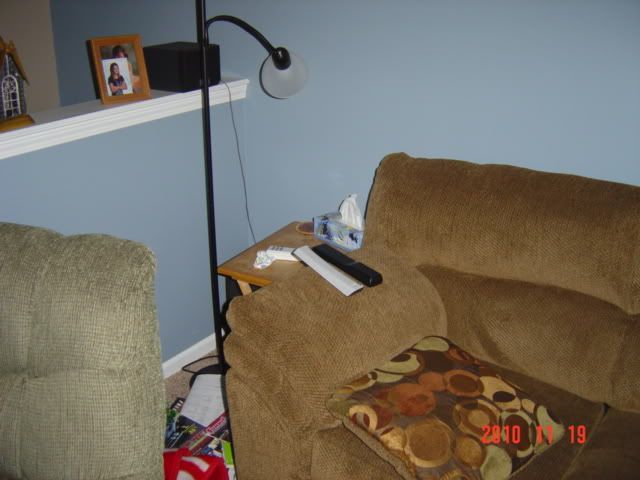

Heres the spot where I would like to put my box. You can see where there's a TV tray. That area is roughly 35"deep x 28"wide x 26"high. So I have plenty of room for a large box. The 35 and 28 are max dimensions so I would have to subtract space for wall and couch clearance but I would like to keep the 26" overall height because it works good with the height of the arm rest on the couch. Also I would like to somewhat mimic the stlye of my TV stand but I can do without the shelf underneath.
SO based on those measurements should I go bigger on the box? I could easily get in the 7-8cu ft range. Also would you suggest down firing or firing out one of the sides which means either forward or into one of the 2 walls or int the side of the couch?

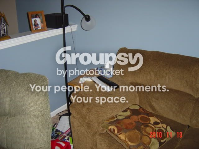

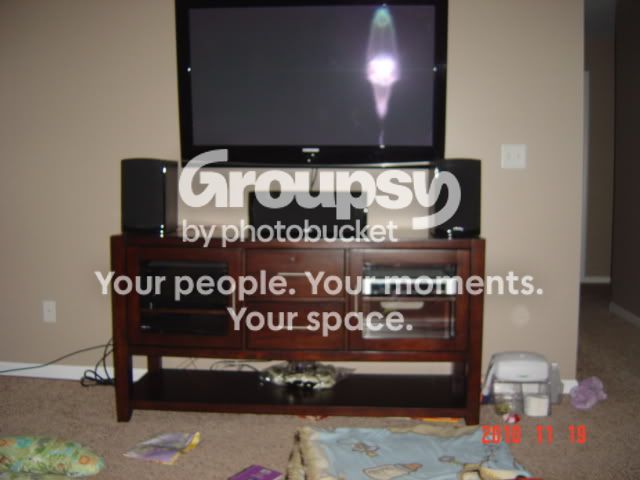

It is hard to know from pictures how a sub will sound in any location. You will get some corner loading, but it is a room that will have a lot of bass leakage anyway.
This box is going to come out I suspect about 5 cu.ft when you are driver, port, amp and bracing the Vb which is just under 1 liter. This box gives you an F3 of 20 Hz and very good spl off just over 110 db. The driver never exceeds xmax (maximum excursion) until below F3 which your subsonic filter will take care of. If you build that box with the slot vent carefully you will have a potent sub, that will exceed the performance of the vast majority of commercial subs.
