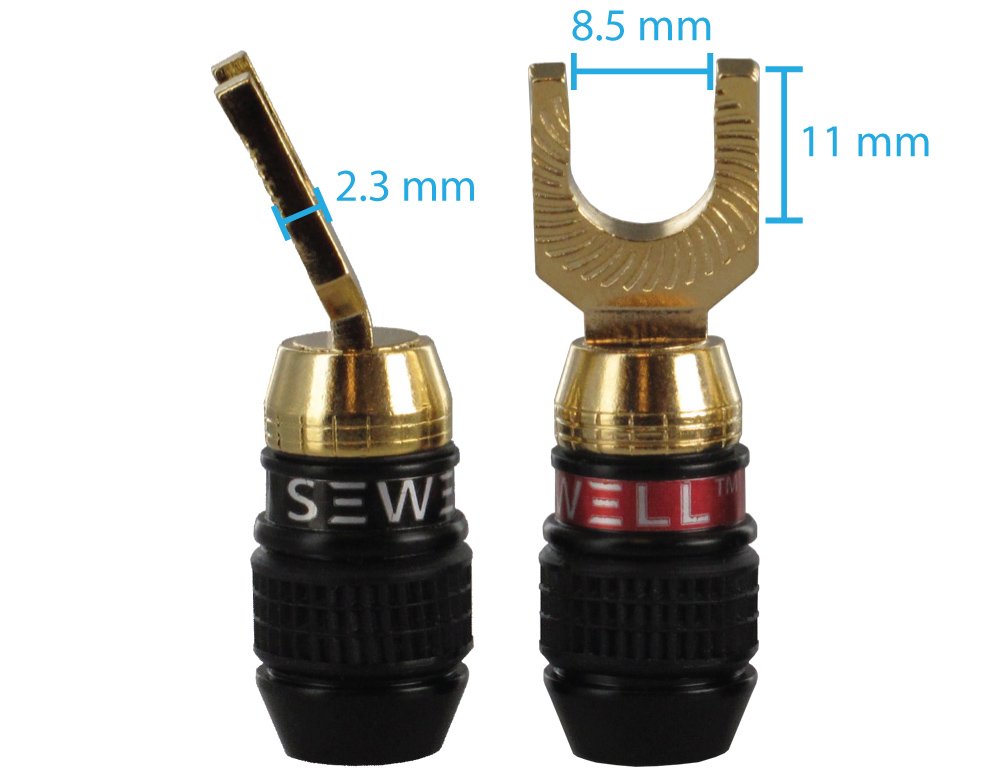

All (except R55Wi) speakers will accept regular old banana connectors with no problem what so ever.
For the R55Wi, you need an angled spade connector. Something like this.
http://www.amazon.com/Sewell-Deadbolt-Spade-Plugs-Pairs/dp/B009KSNVHM/ref=pd_sim_23_4?ie=UTF8&refRID=04E84DGCW65DDVKWXM19
The R55W binding posts looks fairly standard so the Amazon ones above should work, but, just to be 100% sure, you'll need to find out from EMPTek what size to get so that they slot in without too much play and don't stick out beyond the binding post recess. You can e-mail them the Amazon link and they'll tell you, yea or nae.
