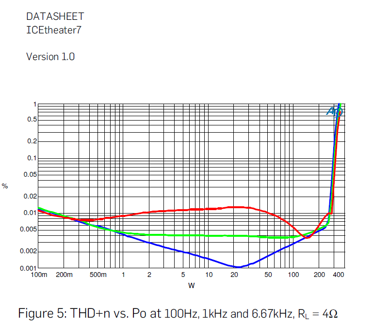

I would hazard a guess that the Emo 7 channel unit will be based on this:
http://www.icepower.dk/en/solutions/theater/
If that's the case, the unit could be significantly shallower than Emotiva's usual offerings. Re: 4 ohm performance, the data-sheet has this graph for power into the load at a few frequencies:
FR appears only marginally impacted by switching from 8 ohms to a 4 ohm load.
Thanks Steve!
I hope you are right (and you probably are), these are going to be hard to beat! That module looks like a great platform.
