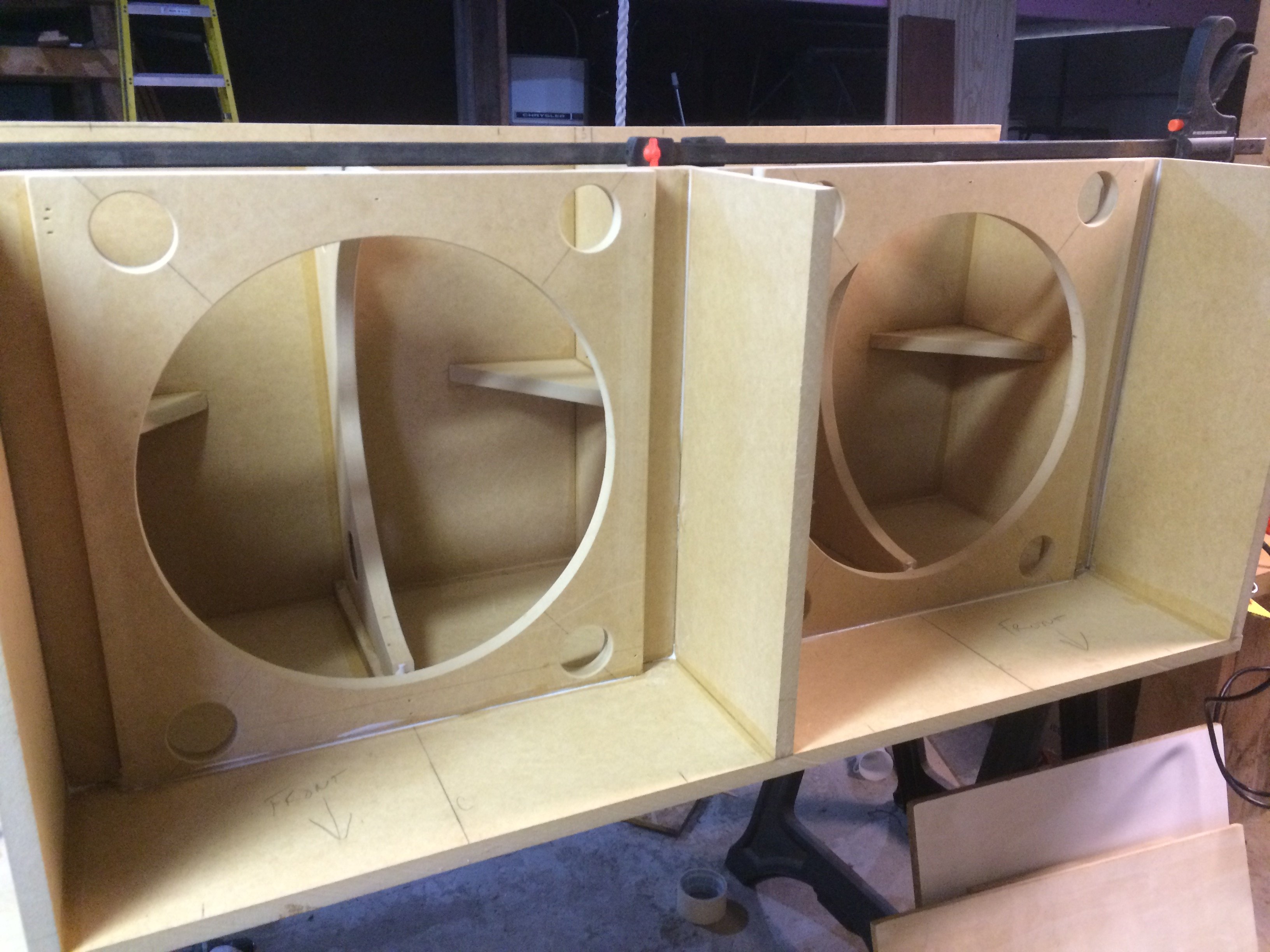

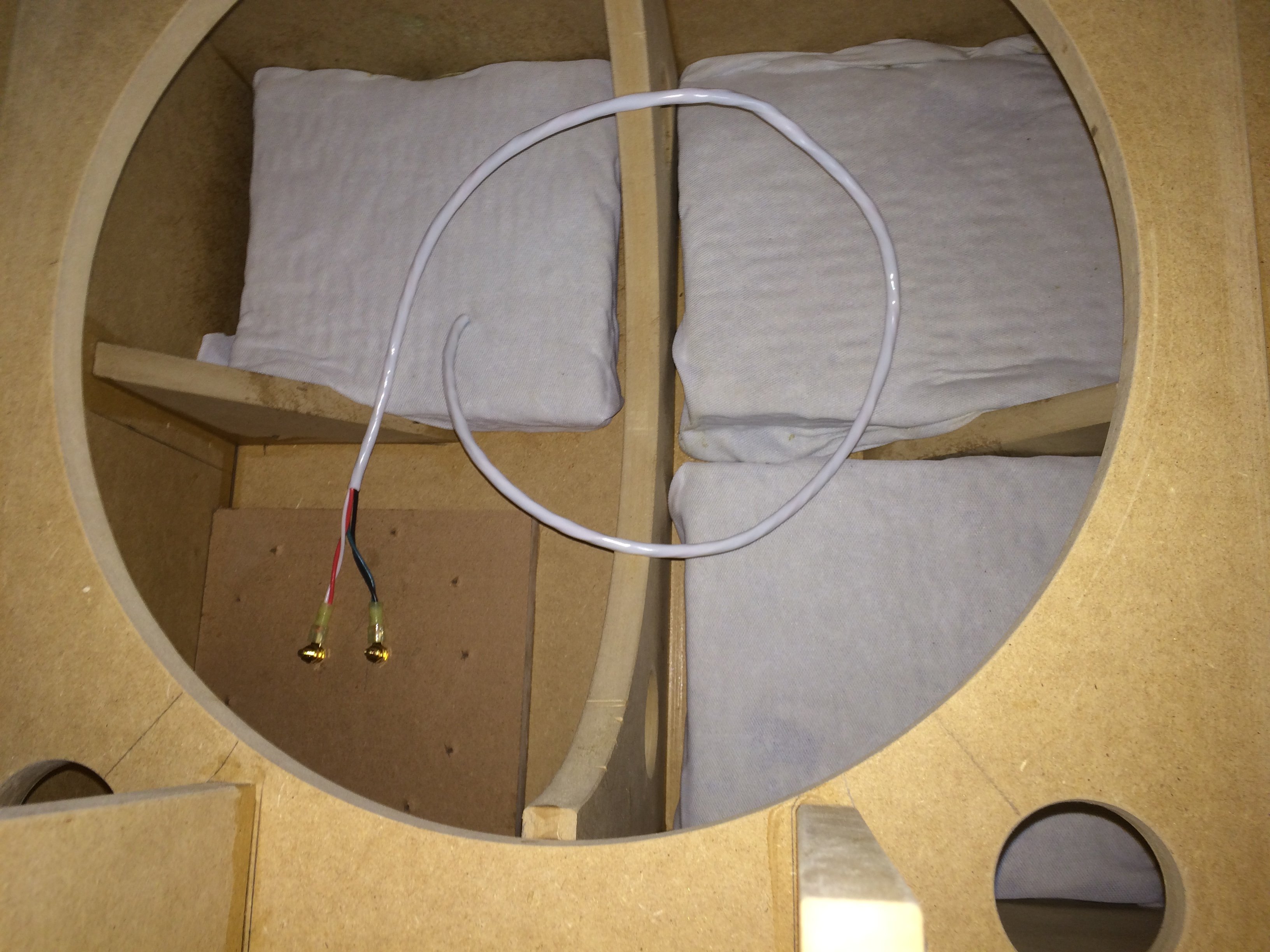

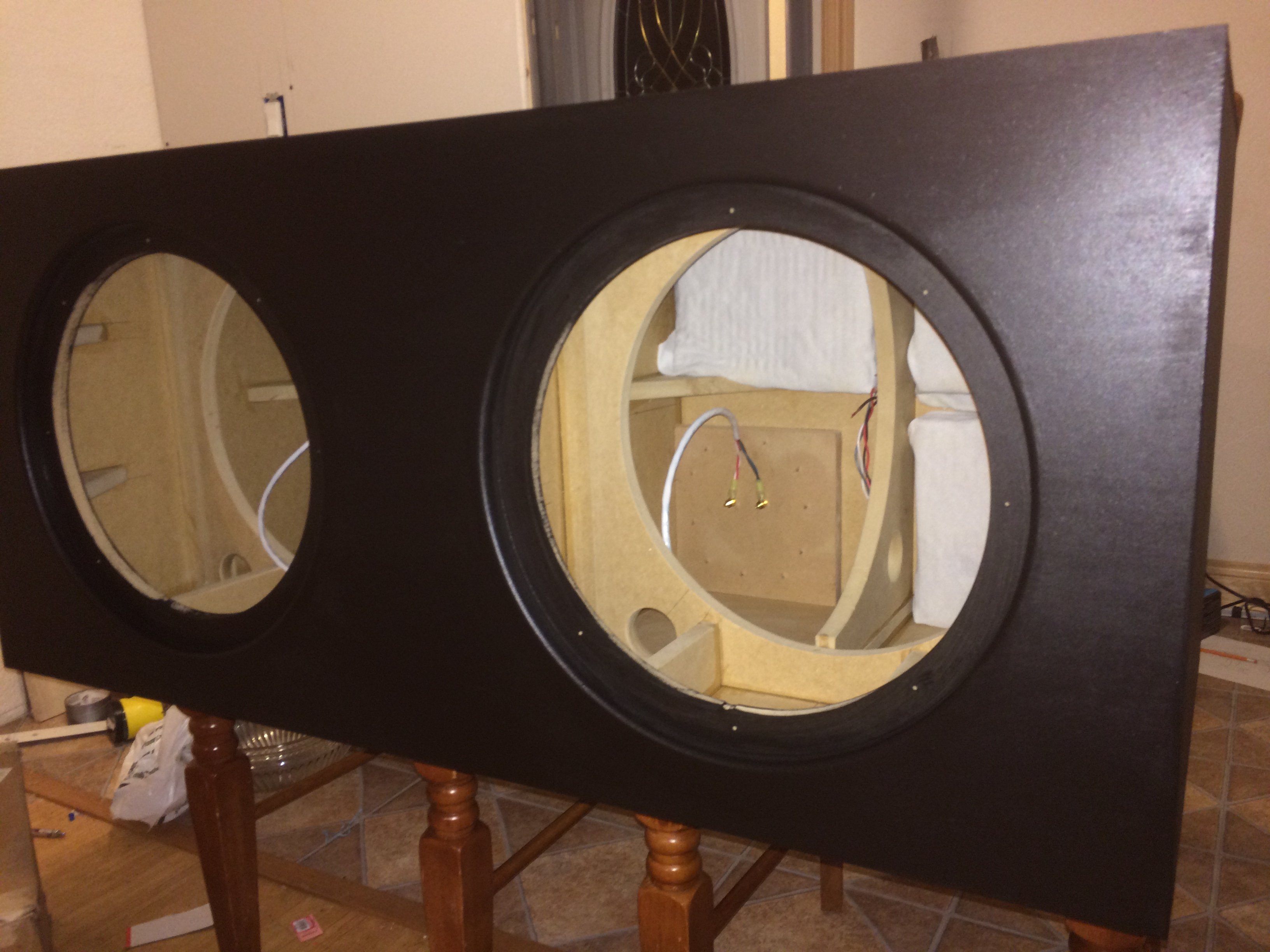

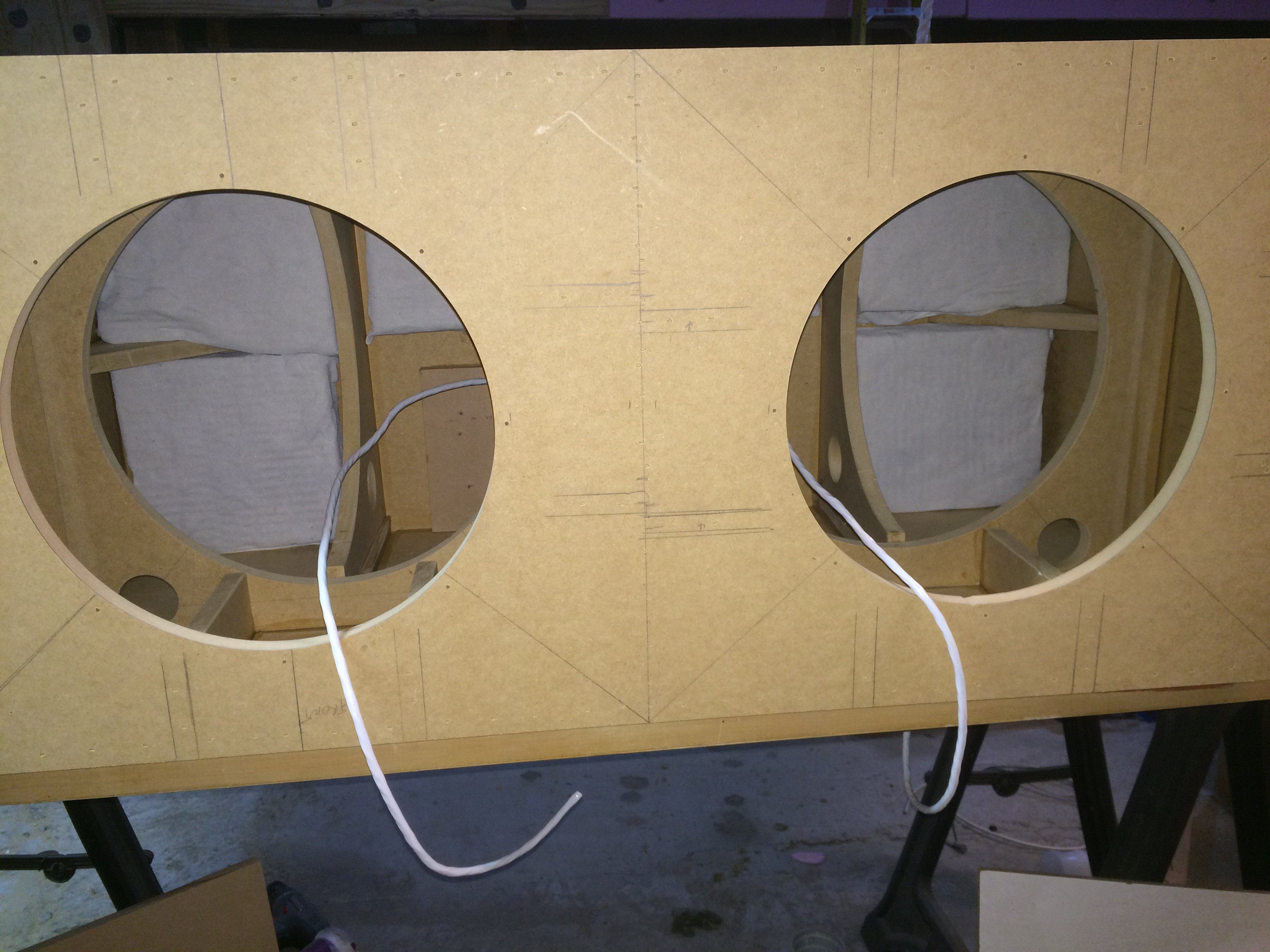

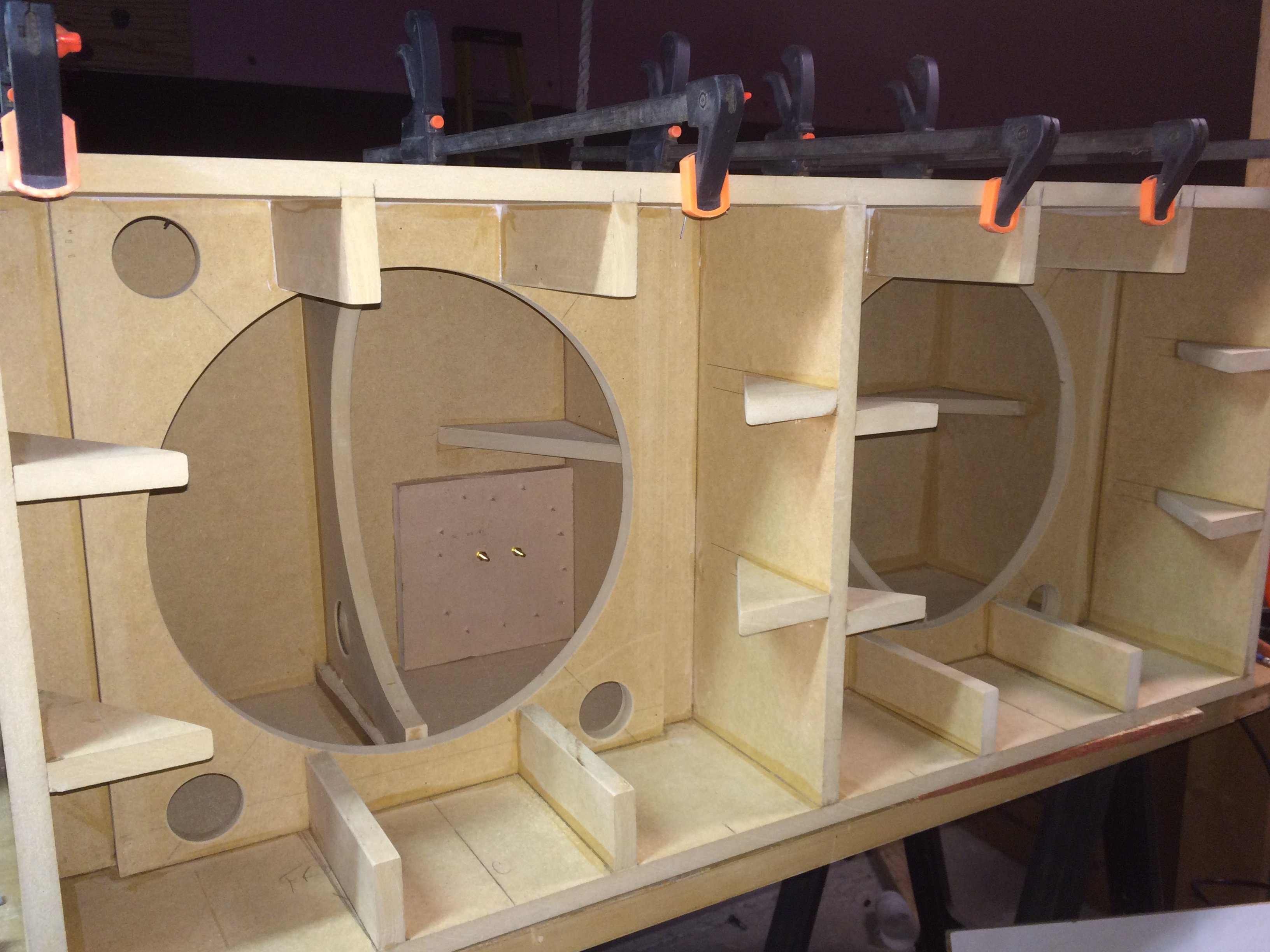

Seems like the better part of a decade since I last posted a build project here. Kinda sad on my part I suppose but, 2 kids and a foster child plus the two we had keeps me a bit busy.
Anyway a friend of mine is doing a theater in his basement. It is a fairly large space so we needed some displacement. We arrived at using dual Pierce Audio 15" 1K subs in 4.5ft^3 net volume sealed enclosures. These are the older versions than what it currently on the site using the pressed pulp/Kevlar cone.
There is a small peak around 58 hz that we will tame with a mini DSP. Overall f3 was 32hz.
I will have to find my model screen shots since this build took a long time between design and execution phases.
Anyway, here are a few pics of the build process.
