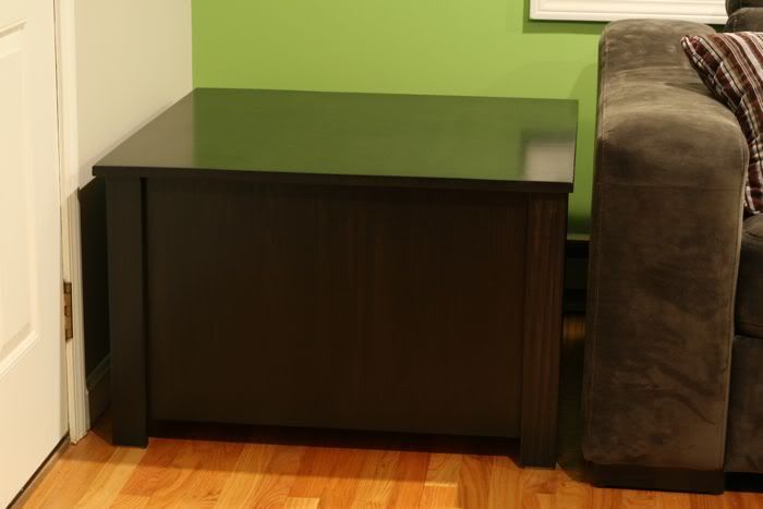

Discreet subs that are fairly grandkid-proof...and that will hang with Tempests (which roll off at ~40 hz)...here is a pic of a Bill Fitzmaurice Table Tuba that would check all the relevant boxes.
Here's a slightly different variation:
