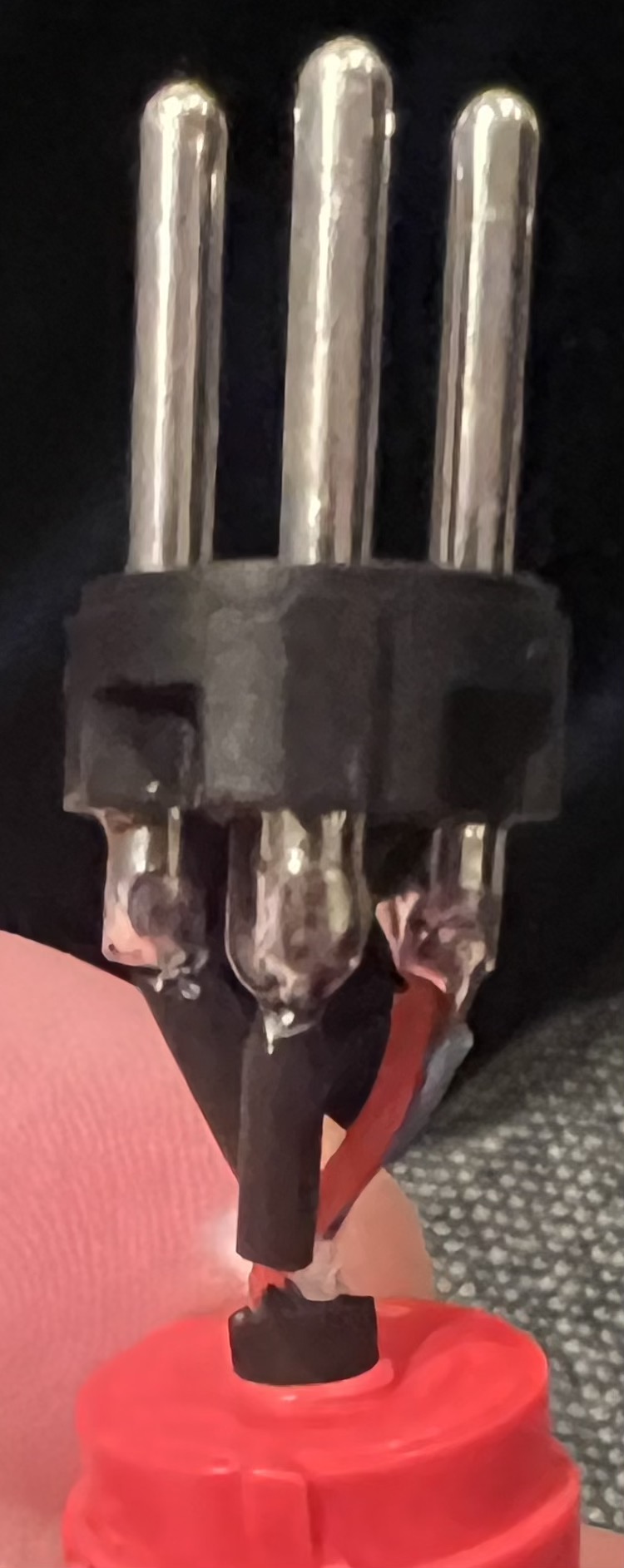

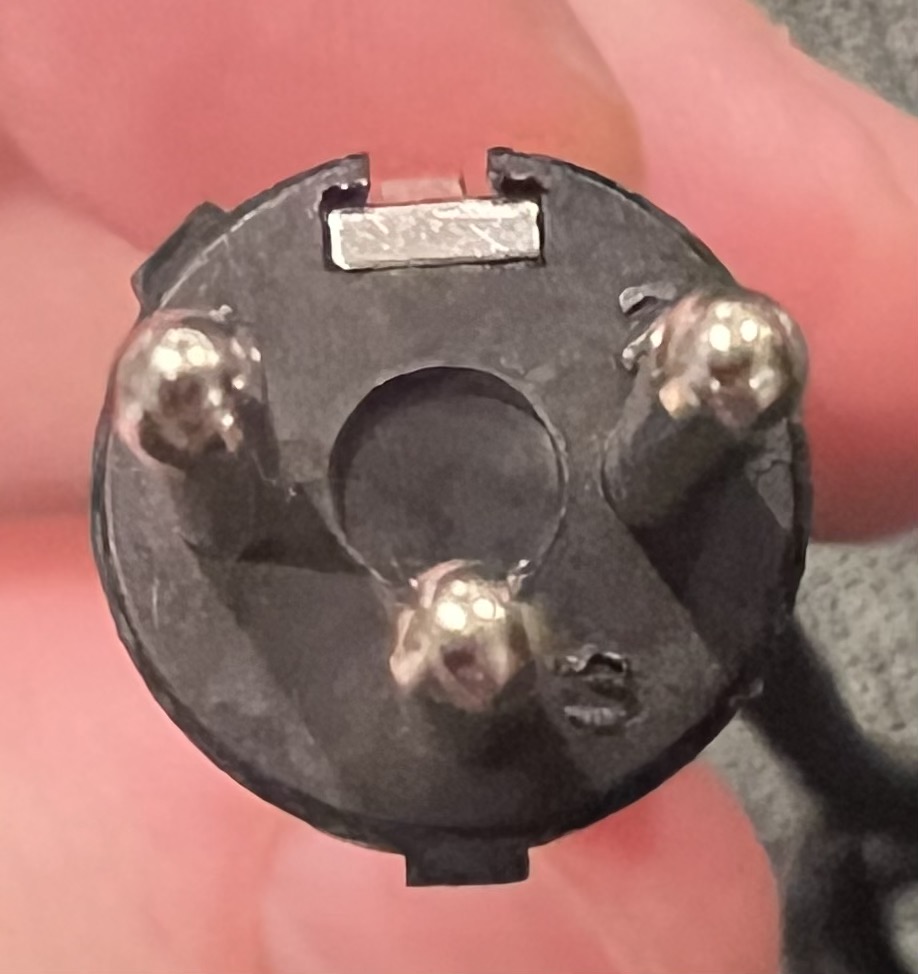

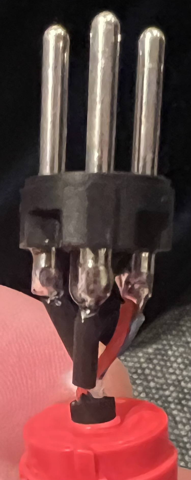

Attached you can find a couple of pictures of the connector and wires. Does it seem correct and can I just go ahead and remove the Pin 1 wire?
View attachment 65041View attachment 65042
Honestly, if the hum is quiet enough with XLR/RCA cables and the classis' connected together with speaker wire, you may be good to go. Any amp will have some amount of noise (hiss) coming out of the tweeter should you put your ear right up to it. So long as its not audible from the listening position, it should be fine.
