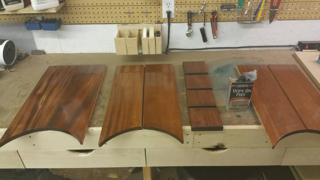

Looks like I might get this all finished up by Monday! Polyurethane is done, the feet are stained (need poly) top is mostly fastened, just waiting for the wipe-on poly to dry on the mahogany before I fasten it. Tonight I should be able to get everything fastened to where it only needs the stainless rods attached. Hopefully they come in the mail today, last I checked they were still in Kansas city, which is a few states away.
On to last night's progress:
This is the top and sides with the final cost of polyurethane as well as the feet.
