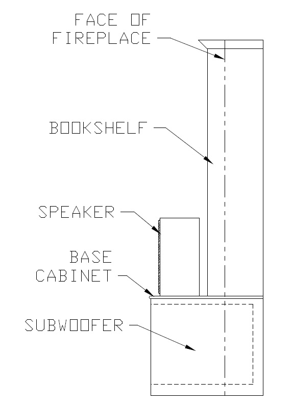

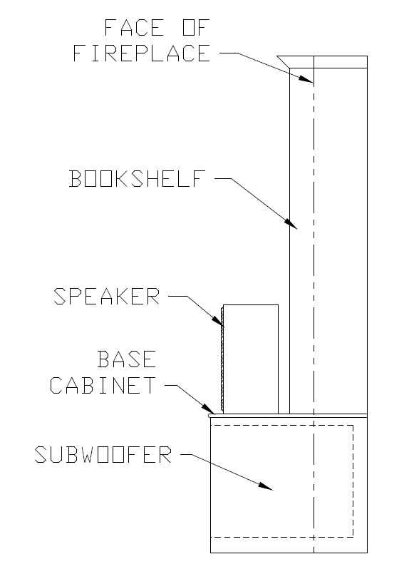

This is a cut section...and the shelves will be full of books...still a bad idea?
You have to understand that a speaker radiates as much sound rear as forward at the frequencies that cabinet will resonate. The shelves will need filling with books to obliterate the spaces behind.
I don't understand the "Face of Fireplace" notation. What is that about? Fireplaces anywhere near electronics are really bad news.

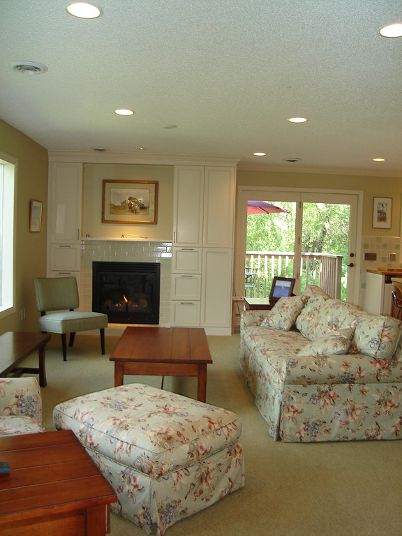

these are built-in bookshelves beside an existing fireplace...the fireplace is being closed off and will not be in use...here is a pic of what is there now...the new built-ins will be 4" past the face of the fireplace where the existing picture shows it almost flush...and the center cabinet that has the tv on it will go in front of where the fireplace used to be...

That is nice brick on that fireplace and a pity to loose it. That brick is very reminiscent of bricks made from clay in the Medway river area of Kent in the SE of England.

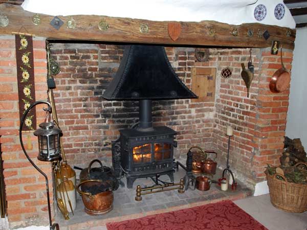

Here is an old farmstead fireplace from a Kent farmhouse.
This is as close as I could get in Minnesota.

That is a beautiful wood stove in the farmstead photo...is that a blower motor in the bottom pic above the fireplace?...have you looked at the old school Elm stoves?...if not a google search is in order...ours is an old Buck stove from the 70's that was installed as a slammer...the chimney is not parged and to make into a working fireplace was going to cost a lot of money as well...our winters are super mild compared to yours so it is really a fluff item to have a fireplace in a house down here...we do like the brick and can always keep it as the backsplash to the tv area...

There are lots of fireplaces in Kent like the one in the top photo, that I grabbed off the net.
The lower picture is my fireplace here at Benedict. There is no blower motor. I think what you are looking at is an antique spring wound clock!
The fireplace is a Wilkening made a about 4 to 5 miles from here. These are fantastic fireplaces. They are economical on wood and give a prodigious heat. That one is 70% efficient. We keep it in 24/7 once the temperature stays below the freezing point. Unless it is below freezing it over heats the house. The heat percolates up through the house. It almost always stays on all night. We burn 4.5 to 5 cords of wood a winter.
Gary Wilkening's fireplaces are just what is required for the Minnesota North country. His latest models are over 80% efficient.

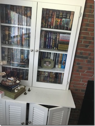

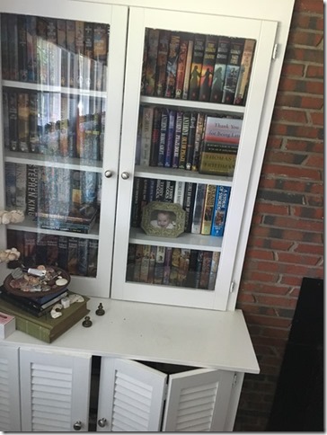

Well it took long enough but I finally got the cabinet built...had to do it myself as the cost to have someone else do it was stupid expensive...this was the test fit...it will be painted tomorrow and then get the final base trim...the TV will be wall mounted and will cover the pink foam board...
