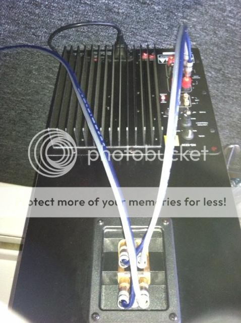

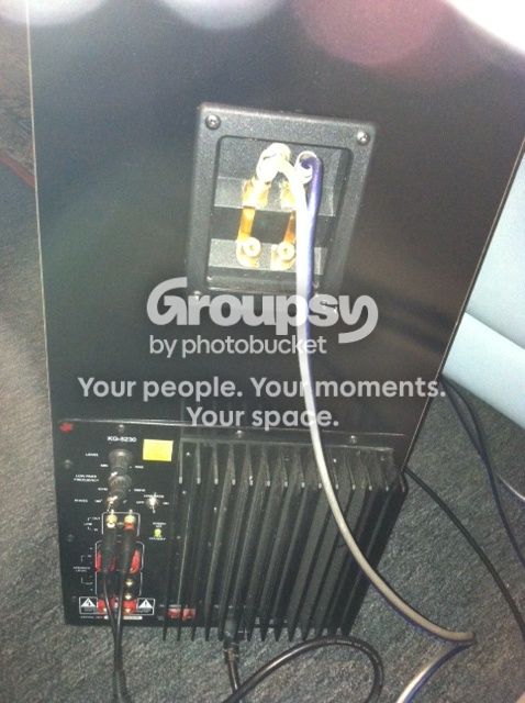

Can you run your towers in a top only and sub configuration> Tops from your L+R speakers and bottoms from sub out.
walter duque
walter duque
What do you mean tops?
My surround towers have powered subs. They can be hooked up in 2 configurations. I can run them full range by turning the low pass filter off or run them with low pass filter on like this
or I can run them with the top section from the amp and the subs from the pre-pro out (like a real sub)
this way it sounds the best because you can use your crossover setting from your AVR. Mine are just 2 speaker systems in one cabinet. They way I have it set up for now is that I use the top section which is a 2 way set-up for my surrounds and the sub section I am using with my plasma display (which has a sub out) this way I get a decent sound when I am watching TV. Am I making any sense or what??
By using both inputs you can set your speakers to small and get the most out of your sub section. When I purchased mine 13+ years ago they sounded impressive to me, but now they are my weakest link in my system. Come to think of it kind of waste of money.
