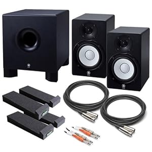

However, I recently got two 8" Yamaha HS80M 'studio' monitors along with the 10" HS10W sub woofer along with a Behringer XENYX X1204USB 12-Channel Mixer.
I am currently using the system in stereo powered over USB audio interface... Sounds great for music, but so-so on movies... lacking surround.

I am just torn which way to go with setup. The yamaha sub takes stereo input and has 3 outputs. The obvious 2 for L/R but the third output is L/R mix. I have been led to believe this is to go to a second sub or a center? So for music I think it would be ideal to have stereo out via usb to the mixer, through DAC to Sub -> 3 monitors. L/R being High pass and C being Mid Pass.
