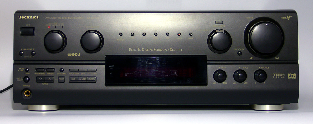

I still have this unit running as a two channel setup upstairs in the family room and it always sounded good.
This is what teh back looks like. I used the 940 model but the backs of teh 930/940 are identical
