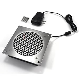

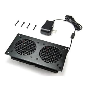

There are several options on Amazon too. Here is a 120mm ready to install for $20 and the same listing has options for single 80, dual 80, dual 120 (for different prices) with silver and black grills.
If you click "AC Infinity" under the product name, a host of other HT cooling products come up.
