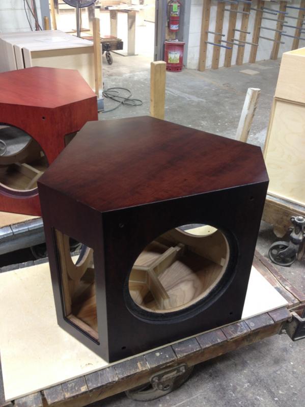

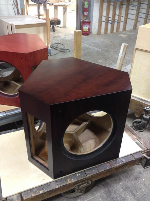

258.jpgOne PSA Triax has more output than dual XV30Fs stacked and even separated, I also believe it has the equivilent output of 3 XS30s, for your room I would definetely call Tom or Jim and they will tell you exactly what you need, I would go out on a limb and say to start with dual XS30s or XV30Fs, they could pressurizi that 3300cf space quite nicely, that's pretty close to my space and I had dual XV15s do quite well in my space, the XS30s also had no problem filling that space with plenty of headroom to spare, these subs are monsters, I can't wait on my Triax (one of these will do the trick for you also) duals would be insane, I am considering a second but I am a pig. I'm chatting with my man Alex (Fuzz) about doing some DIY kits for mains with big drivers, I just can't help myself with big stuff :D, that's the same reaction I get from my wife ;). Go with as much as you can afford, to me it's never enough, but like I said I'm :eek: If you don't mind moving a 200 ilb. subwoofer around I would seriously consider the Triax, here's mine waiting for drivers.
Call Tom and Jim and talk it over with them or email them
support@powersoundaudio.com You'll be glad you did, friendliest and knowledgeble guys in the business.

View attachment 12315One PSA Triax has more output than dual XV30Fs stacked and even separated, I also believe it has the equivilent output of 3 XS30s, for your room I would definetely call Tom or Jim and they will tell you exactly what you need, I would go out on a limb and say to start with dual XS30s or XV30Fs, they could pressurizi that 3300cf space quite nicely, that's pretty close to my space and I had dual XV15s do quite well in my space, the XS30s also had no problem filling that space with plenty of headroom to spare, these subs are monsters, I can't wait on my Triax (one of these will do the trick for you also) duals would be insane, I am considering a second but I am a pig. I'm chatting with my man Alex (Fuzz) about doing some DIY kits for mains with big drivers, I just can't help myself with big stuff :D, that's the same reaction I get from my wife ;). Go with as much as you can afford, to me it's never enough, but like I said I'm :eek: If you don't mind moving a 200 ilb. subwoofer around I would seriously consider the Triax, here's mine waiting for drivers.
Cheers Jeff
My wife paid over $1000 just for one of them coffee tables they are using to roll the subs around on... Furniture Factory Cart | Coffee Tables | Restoration Hardware I have to admit at first I was like $1000 coffee table WTF? but that thing gets more attention by guests than my $15K 1940s wurlitzer juke box.. that company makes some cool stuff, check out this tv stand Gunmetal TV Easel | Plinths & Columns | Restoration Hardware
