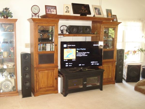

I could mount a shelf right above the TV, but then its way above listening level.
Mine is above the TV, "way above listening level".
I have no complaints, and think it sounds great. Voices for TV/Movies sound like they're coming out of the TV. I have never thought it seemed odd or misplaced.
Since this pic, I did angle the center down a little more, so more directly pointed at our chairs. But if this is one of your easier options, I wouldn't worry about it for a minute.
