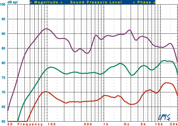

I don't know what the price is for those speakers, but I see major flaws in the frequency response graphs of those speakers. See the large step up that is between 500 Hz and 1 kHz, right in the middle of the mid range where our hearing is most sensitive. It's about 10 dB, you will definitely hear that. And I'm guessing it won't sound good. The rest of this speaker's frequency response above and below the mid range is also ragged looking. The bass is heavily exaggerated, and although that may sound attractive at first, it will ultimately sound boomy. There are better sounding speakers with smoother looking frequency response curves.
http://www.soundstagenetwork.com/index.php?option=com_content&view=article&id=835:nrc-measurements-fluance-xl7f-loudspeakers&catid=77:loudspeaker-measurements
http://www.soundandvision.com/content/fluance-xl7f-speaker-system-test-bench
Look at the purple trace. It looks similar to the graph above.
Is it just me, or does it look like the polarity of the mid-range might have been reversed on the test speakers? Those notches could also be from a mic that wasn't aligned properly- the link shows a much better response.
http://fluance.com/product/XL7F_High_Performance_Three_way_Floorstanding_Loudspeakers.eng-7.html
The review shows "Chart A: 20Hz - 20kHz (measured @ 2m, plotted @ 1m)"
Fluance says the crossover frequencies for the XL7F are at 800 and 3500 Hz. The large step that appears in the FR curves is at about 500 to 700 Hz and is centered at 600 Hz. If the mid range drivers were accidentally wired out of phase with the woofer, I'd expect to see a V shaped dip centered at 800 Hz.
Also both Sound & Vision and SoundStage measurements showed similar results from what I'd expect were different examples of the speaker. Interestingly, Fluance chose to ignore those and show a third measurement which differs. Personally, I'd trust what SoundStage publishes.

The linked trace is from the manufacturer and the scale is compressed by a facotr of two.
I think it is pretty clear that speaker has trouble where the ear is very sensitive.
I think that speaker will sound bad. Don't trust most subjective reviews, especially not from owners and subjective reviews in the press are next to useless.
I personally would stay well wide of that speaker.
This is one of the reasons I like to run response tests- I have seen production-model speakers with wiring errors, for whatever reason, and it makes corrections very easy. I would have expected the dips to correspond to their stated crossover points too, but it's hard to know if something was out of spec, a component was changed without updating the data, etc.
