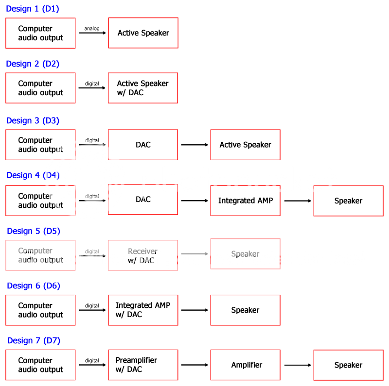

    I'm willing to build a small audio system. It's mainly for enjoying FLAC audio in my room (about 7 x 15 feet or 230 x 460 cm).
    Requirements (subject to changes):
    • Channels: 2.1
    • Audio power: 50W
    I'm considering the following architecture:
    [​IMG]
    Here's my questions:
    Architecture
    1) Is this a good setup? Is it a overkill for just 50W? What do you suggest? Simply a receiver?​
    Components
    2) What brands and models do you suggest?
    • receiver
    • preamplifier
    • amplifier
    • loudspeakers
    • cables and other parts
    Cost
    3) Roughly, how much a setup like that (or like your suggestion) would cost?​
    Unanticipated concerns
    4) What are the most important technical details I'll have to pay attention to?
    (eg. impedance has to match between the subsystems, loudspeaker has to support x% more power than the amplifier, etc)​
    If I said something wrong, irrelevant or simply forgot about important things, please pardon my ignorance. I'm completely new in this subject. Thanks in advance!

    Unfortunately onboard audio. It does have digital outputs though.
    Budget is $500 USD. It can go a bit upper (if I deallocate from other budgets like computer upgrades! ^^)
    I did. Too costly for my budget unfortunately. :(
    I thought that the subwoofer was "mandatory" to give a good listening experience, was I wrong? If you say "yes", I'll be happy because it's one less component to spend money on. :D
    Of course! At the end of this message I will list the suggested designs so that you can help me to pick one (or eliminate one).
    Fellow audioholics forumers, which design choice would you pick (picture below), considering:
    Budget
    $500 USD
    Purpose
    Listening to FLAC audio in my room
    Room size
    7 x 15 feet (230 x 460 cm)
    Audio power
    50W
    Source
    My desktop computer
    If, for a bit more budget (or a bit more than a bit :p) you would pick other design choice not restricted to $500, please post a reply explaining why it would be a better choice.
    Design choices
    [​IMG]

    So here's the definition:
    Schiit Modi $99.00
    Topping TP60 $210.00
    Mordaunt-Short - Aviano 2 $399.00
    TOTAL $708.00
    I think the part that brings more discussion is the speaker choice. Please feel free to make your suggestions. Budget is locked at $700 now.
