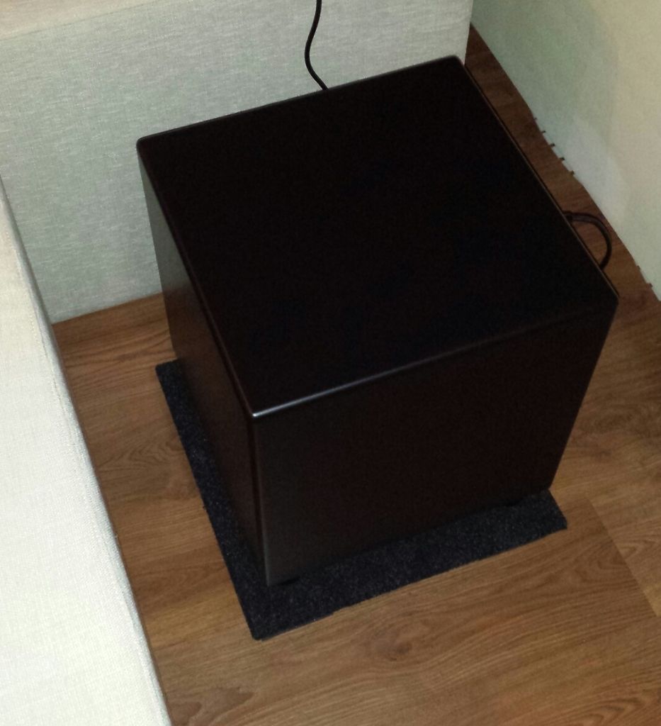

So I got my XXLS400-DF on the friday and got it installed, was pretty amazed from it straight away out of box. On saturday I took the time to correctly calibrate it with my receiver and it sure has more kick than I could ask, only using 1/4 th of its power to match my speakers in my room!
After calibration I listened to some of my favourite songs and the sound world I was getting got me almost crying.. With music this sub sounds so beautiful and integrates really well and takes load out of my speakers and allow the speakers shine even more. I tried some short movie tracks as well and it sounds really nice! For movies I hope I was allowed to buy another one as my sub location is not perfect and I'm able to locate the sub, but with music I cant locate it. Have to do some more movie testing still with this sub and play with the settings, maybe I'm able to hide it with movies as well in this location. And for sure I would order another one straight away if I was allowed to! Best 750€ upgrade so far on my setup and I'm happy that I saved those 1150€ versus the SVS SB13-ultra, ofcourse I cant compare to SB13-ultra as I havent heard it, but I'm more than satisfied with this little beast.
The finish on unit is really nice as well! Sorry for the bad picture with phone:
