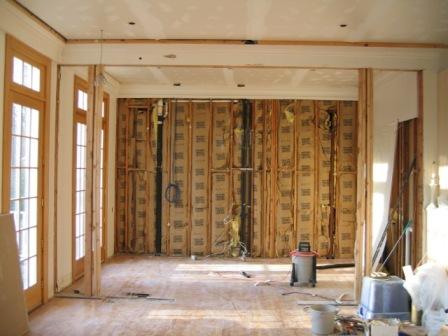

Torn down sheetrock & insulation from wall

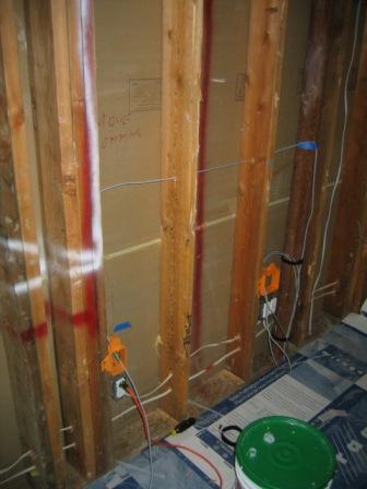

Installed low voltage gang boxes for each PC, each printer and an eight-gang box for all the AV & info lines for the AVR.
I have also added two 1" diameter flexible conduits for the main PC and the 8-gang box for future needs.

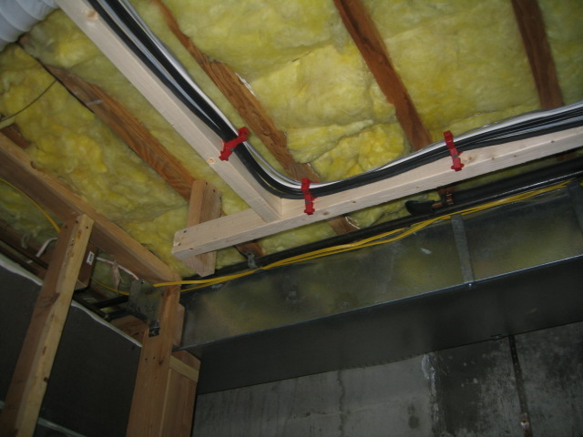

If it works, I have attached photos of the wall before the work, two shots of the gang boxes and a look at the cable carrying rail that I built.

If you have basement access, then you might consider just dropping a few pieces of 3/4" conduit to several locations now. It will make access that much easier should you need it later on. Blue 3/4" flex conduit is available from Home Depot for about 3 bucks for 10 feet. I picked up 100 feet at www.smarthome.com and put it to use.

Anyway, conduit most definitely is your friend and takes about 5 minutes per location to install and makes adding wires later much, much easier.
