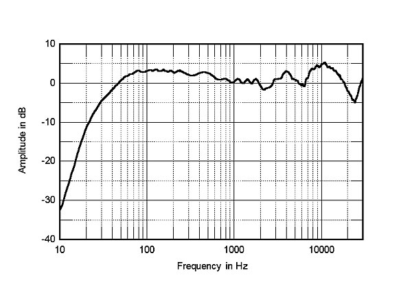

There are plenty of B&W Diamond measurements (D1, D2, & D3 generations) from Stereophile, which not only show the on-axis, but off-axis responses, which is rather infamous for being not very smooth.
So I guess the question is, whom do you trust more? Stereophile or Newport?
I guess it all depends on who is doing the measurements for any given speaker?
If all the B&W speaker measurements from Stereophile, HTM, S&V Magazine, and Soundstage all looked like that one from "Newport Test Lab" (response of +/-2.5dB?), I think most people would be singing a different tune all these years regarding B&W speakers.
I just saw another in-room response for the Revel F208 from "Newport Test Labs". It was like ruler flat +/- 0.5dB. :D
Stereophile and S&V measured the F208, and the response was more like +/-2.0dB.
So just take whatever "Newport Test Labs" has and add another +/-1.5dB. :D

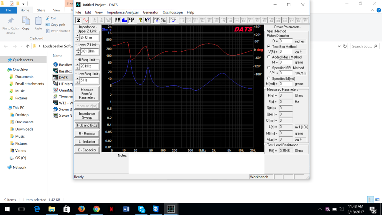

This is my measurement of a B & W 800 D3
The black line is 90 degrees off axis. The blue in axis and the yellow 15 degrees off axis. You can see that the output to the room is actually very good.
The waterfall response is excellent.
Impedance curve and phase angles.
That is not a terrible load for any decent amp to drive. Not for a receiver, but who is going to drive speakers like that with a receiver?
