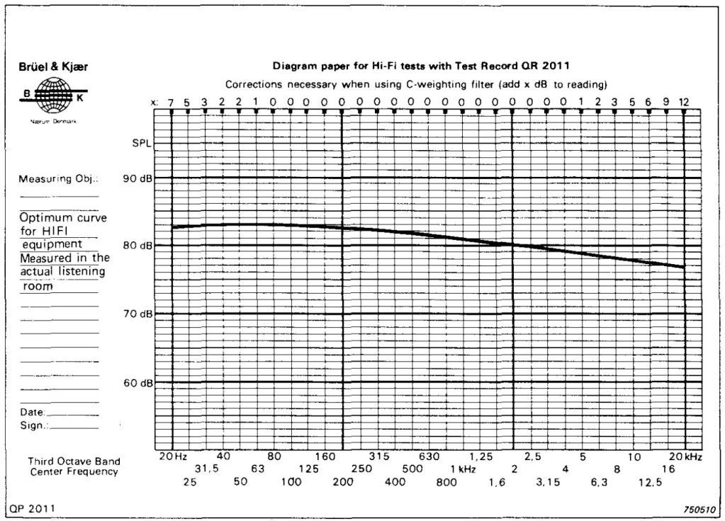

You mean this curve?
This curve is used to equalize studio speakers to the listening position. That is pretty much the curve you will get at the listening position from speakers that measure well. That is my point, Audyssey corrects it, and I maintain it shouldn't. But if what you like is flat at the listening position go ahead.
That curve is almost exactly what I shoot for at my listening seat. I arrived at it by using recordings I made in my listening room, and trying to make them sound as realistic as possible. And here I thought I was running my bass octaves just a little hot; it looks like I'm pretty much on target.

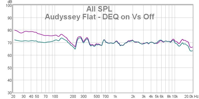

The graph I posted shows that Audyssey curve is down about -6dB @ 10kHz (~69dB, Reference is 75dB). At 20kHz, it is down -10dB. I assume it varies with speakers/rooms?
Green is the Audyssey Curve, Reference level is 75dB:
But yeah, I think all the Audyssey graphs I've seen showed a roll-off in the treble, unless you use Audyssey Flat + Dynamic EQ. :D
Here is one example, where 70dB is the reference level. Purple graph is FLAT + DEQ, Green graph is FLAT only.

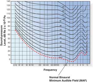

I think you're confusing Dynamic Volume with Dynamic EQ. You should read about the differences over at the Audyssey forum by Chris Kyriakakis.
It's not about increasing the levels. For example, I could increase the subwoofer channel levels to be 12dB hot and the bass would still not sound as punchy, dynamic, and musical as when I turn on Dynamic EQ.
Dynamic Volume basically just increases all the low levels like dynamic compression. I don't like that. But some people have use for Dynamic Volume with certain situations so I won't presume to tell people that what they are doing is a bad idea.
What you really discovered were the old Fletcher/Munson curves of the old loudness button.
That was a bad idea also.
They are similar as they both raise both ends of the frequency spectrum. Dynamic volume and the old loudness control just increase it as the volume was reduced. Neither have anything to recommend them.
