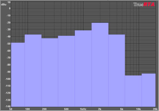

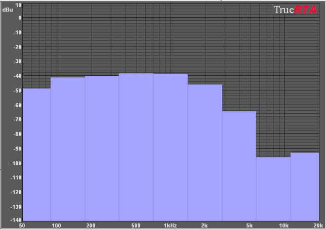

i messed with it for awhile, and here is a snapshot from listening to some rap, and the bottom one is with white noise. This was tuned using my cheap microphone i bought for gaming. I will buy a good one soon for my speakers.
