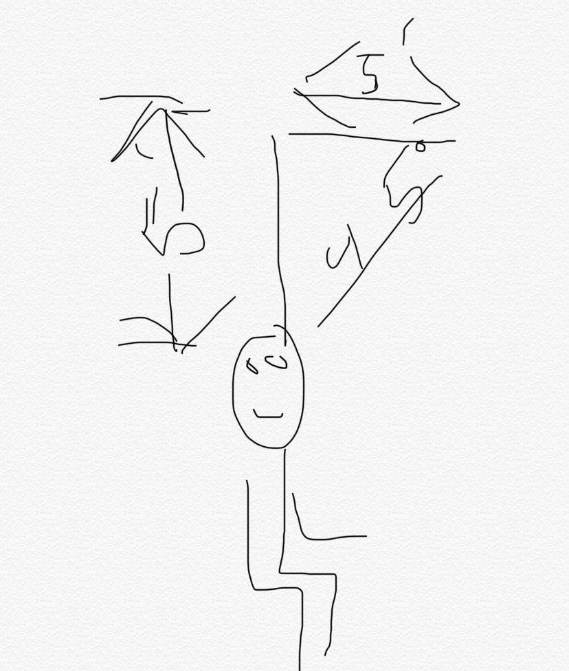

I have attached a drawing for simplicity of using a 20’ x 20’ room with 8’ ceilings. Sorry I for the sketch as I don’t know how to do it on a computer.
based on my sketch of having the MLP 11’ from the front wall, the Atmos speakers would be 6’ in from the front and 5’ in from the side. So on the sketch of the top view, is it more of where those two points intersect A or the radius of the two B? At that point do I just turn the 35* speakers towards the MLP?

It would go in A. Basically measure from seated ear height to ceiling. Then go that distance fore and aft. Then straight line across the ceiling.
And yeah, I’d swivel them to hit the MLP

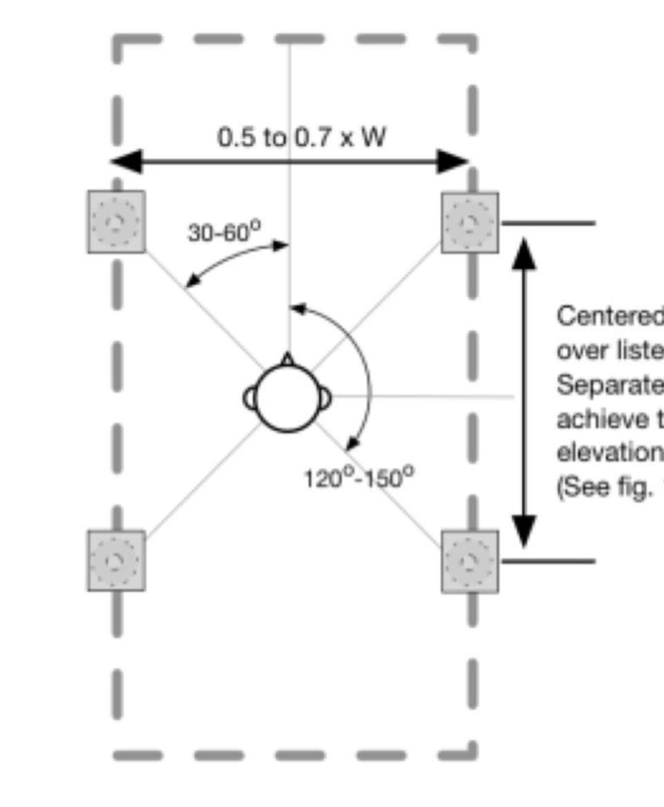

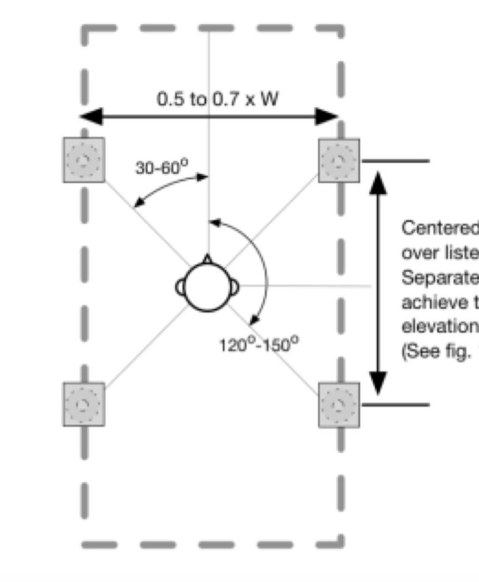

On the top of this diagram, what does the “0.5 to 0.7 x W” mean?
William Lemmerhirt
William Lemmerhirt
It means they’d be installed from .5 to .7 width of the widest speakers. Usually the surrounds. So in my room of 16’ wide, the width of my tops could be between 8’ and 11.5’ apart. As ryan mentioned, you don’t have to hit the angles exactly.
