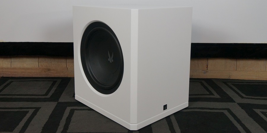

Among Arendal Sound's subwoofers, I have reviewed all but one, but today, I will be examining the final sub of the six that they offer, the 1723 Subwoofer 2S. I don’t expect any surprises in this review since I am familiar with Arendal’s design philosophy at this point. However, I am still excited to get my hands on this sub since I think it may be the sweet spot among Arendal’s subwoofer offerings. The reason why I think the 2S could be their finest sub is the performance density per liter that it could provide. To put it another way, it could possibly pack more punch for its size than any other sub from Arendal. While the 1723 Subwoofer 2V is certainly Arendal’s highest performer, it is a behemoth that weighs over 130 lbs., and stands 27” tall. It is simply too large and heavy for most people. It is almost twice the size of the 2S at 13,000 cubic inches vs. 7,000 cubic inches, and that extra 40 lbs. pushes it over from being merely heavy to massively heavy. While the 2S will give up output from perhaps 40Hz to 16Hz versus the 2V, it is far more physically manageable and won’t be a gigantic presence in-room, but I would still expect pretty tremendous performance from this dual 13.8” driver, 1,200-watt subwoofer.
But the question is, does it actually provide the performance that it promises based on Arendal’s other subs? Read our full review to find out…
READ: Arendal Sound 1723 Subwoofer 2S Review
