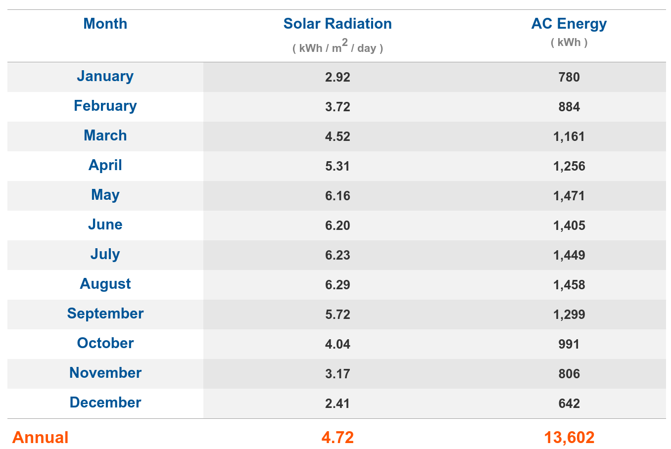

Well, they won't permit for a personal nuclear power plant, so I have a south facing roof and the PVWatts calculator gives me this for estimated solar fall:
Now my home energy requirements only peak past 1000 in June, July August. So my thoughts are is to size an array that covers my 100% need for 9 months and then ~70% for the summer.

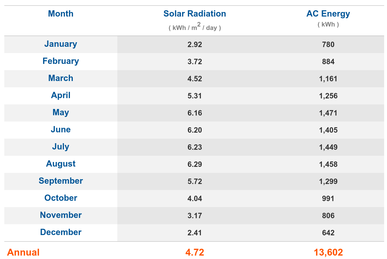

Well, they won't permit for a personal nuclear power plant, so I have south facing roof access and the PVWatts calculator give me this for estimated solar fall:
For you it might pay off, but I doubt you will recover the capital cost. Those numbers would not work for us, especially in the winter. We use electricity for cooking and in the winter, for us it would not be much use. For us even if we had a south facing roof, our winter numbers would be far worse as we are further north.
Then you will have to factor in the cost of maintaining and replacing batteries. You will need them in the night time hours. You will need batteries as if you don't capture the excess daytime production, it will not be worth it.

I'm looking at 400 amp hour worth of battery and grid tied inverter that prevent backfeed upon power outage. I can do ~6400 watts of panel for ~$12K. I can install and pay an electrician to pull permits and wire into the panel.
The thing that kicked it off is that a 10Kwh generac is ~$6500 installed and it just sits there doing nothing.
I need to get a year of usage in the new house but I think this can be paying for itself in 9 - 10 years.
The Litihium-Iron-Phosphate batteries are good for about 12 years.
I get cost savings and I get lights out protection.

I'm trying to get the 2021 usage for the house I moved to. If my hunch that July/August are outlier usage months and the rest of the year falls in line I think if I can pull off ~$9K for a 6/7Kwatt array and a 400 amp / 48v battery backup that it will save me $900 a year and I have power in the event of an outage. I would be looking @ ~ 7 year payoff. Plus I would get a 30% tax break.
A 10KWH Generac is ~$6500 and that's a sunk cost.

The thing is with at least the tax rebate solar gets very close to the installed cost of a generator and I can reduce my energy bill.
I'll keep things updated when I can figure out what size system I can get that meets the mean and not the peak usage.
Stop me if my thinking is incorrect: If I only peak at 1200-1400Kwh for 2/2.5 months out of the year and the rest is sub 1000 I should stand pat on a lower cost system that could cover me for 10 months at 100% or better.
