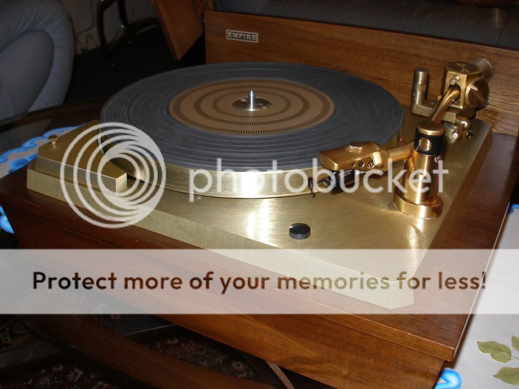

I think you're right. Now I kind of regret selling my old Empire a few years back, just couldn't find a new stylus for it anywhere, it got bend when moving.
