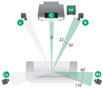

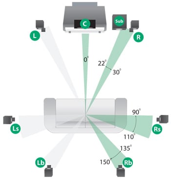

To add to the above, the recommended locations for the rear speakers is different between a 5.1 and 7.1 setup (see the images below and the Audioholics article linked here). So, if you follow the standard setup guidelines, you'd slightly relocate your surround speakers when you upgrade. So, just something to consider as you plan the lengths of speaker wires in your install. That said, I never ran the standard setup for my 5.1 and always had my rear speakers placed where the 7.1 "surround back" speakers are, so when I added another two speakers, I just added them off to the sides.

5.1 Layout
7.1 Layout
