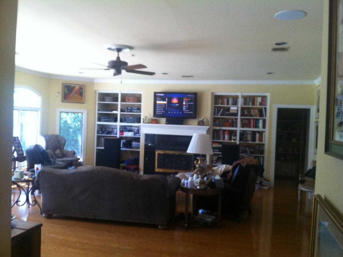

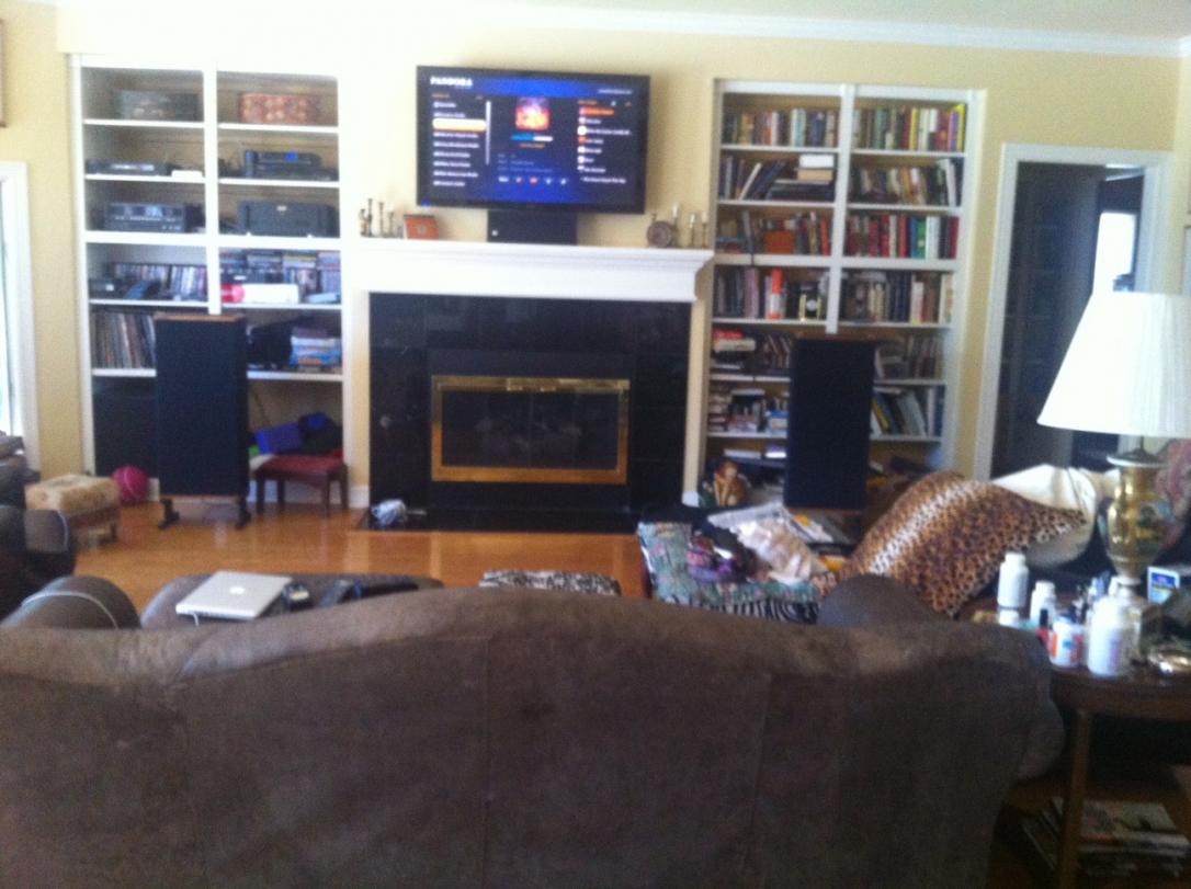

The left side is mostly glass, the right is mostly open to another room. Floors are hardwood, ceilings drywall I guess.
Here are some pics. For reference, the plasma is 50". The room is about 25x23.
