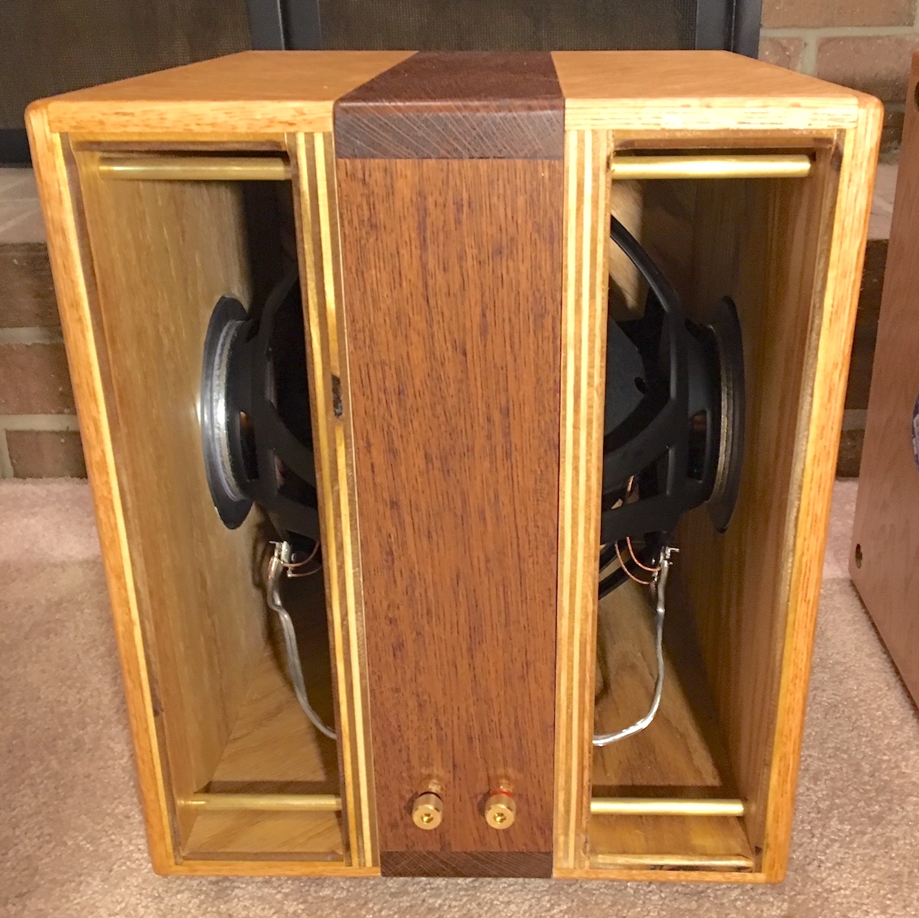

Build info:
The woofers are Peerless SLS 12's and the cabs are 3/4 red oak plywood with oak edge members inserted and rounded over, which looks much better than exposed plywood edges but is a LOT MORE work. The center section is solid brown oak, indexed to the cabs with oak dowel pins. The cabs and center section are held together with all-thread rods and cap nuts.
The light-colored oak cabs were oil stained with a mixture of 1/3 golden oak, 2/3 natural, and a bit of powdered turmeric root added for a yellowish tint. The darker oak center section was oil stained with red oak, for contrast. The finish is sprayed-on coats of clear satin polyurethane with a #320 sanding step between coats.
Enjoy!
Charlie in Savannah, GA

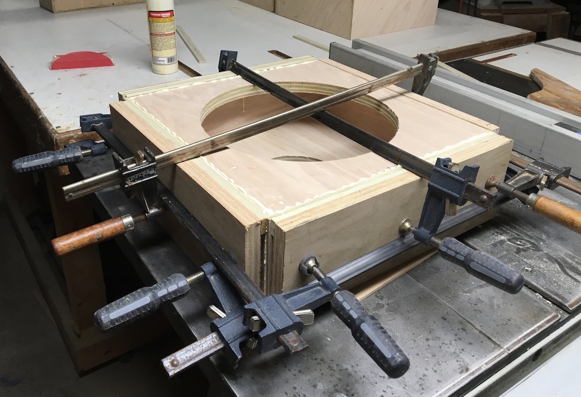

Photo 1: Rabbited plywood cab pieces self-locate and bank together for gluing.

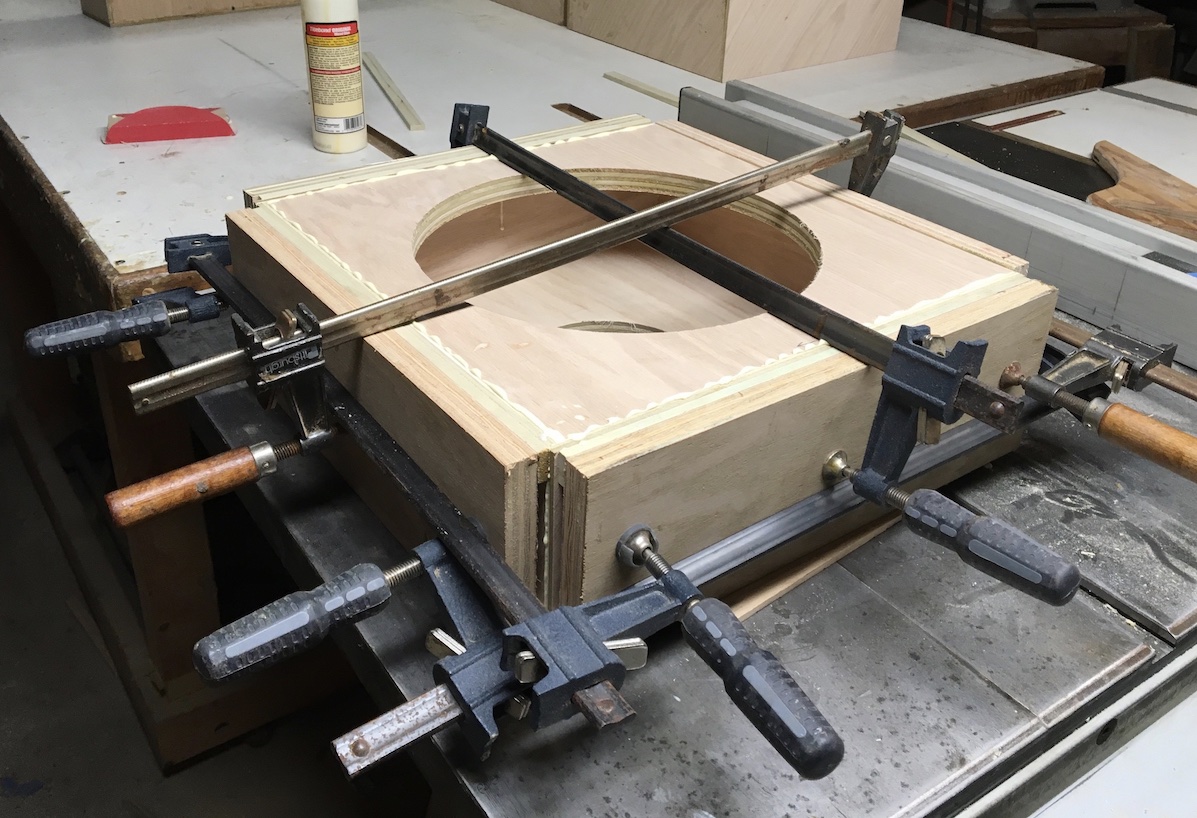

Below: Cab glued and clamped.

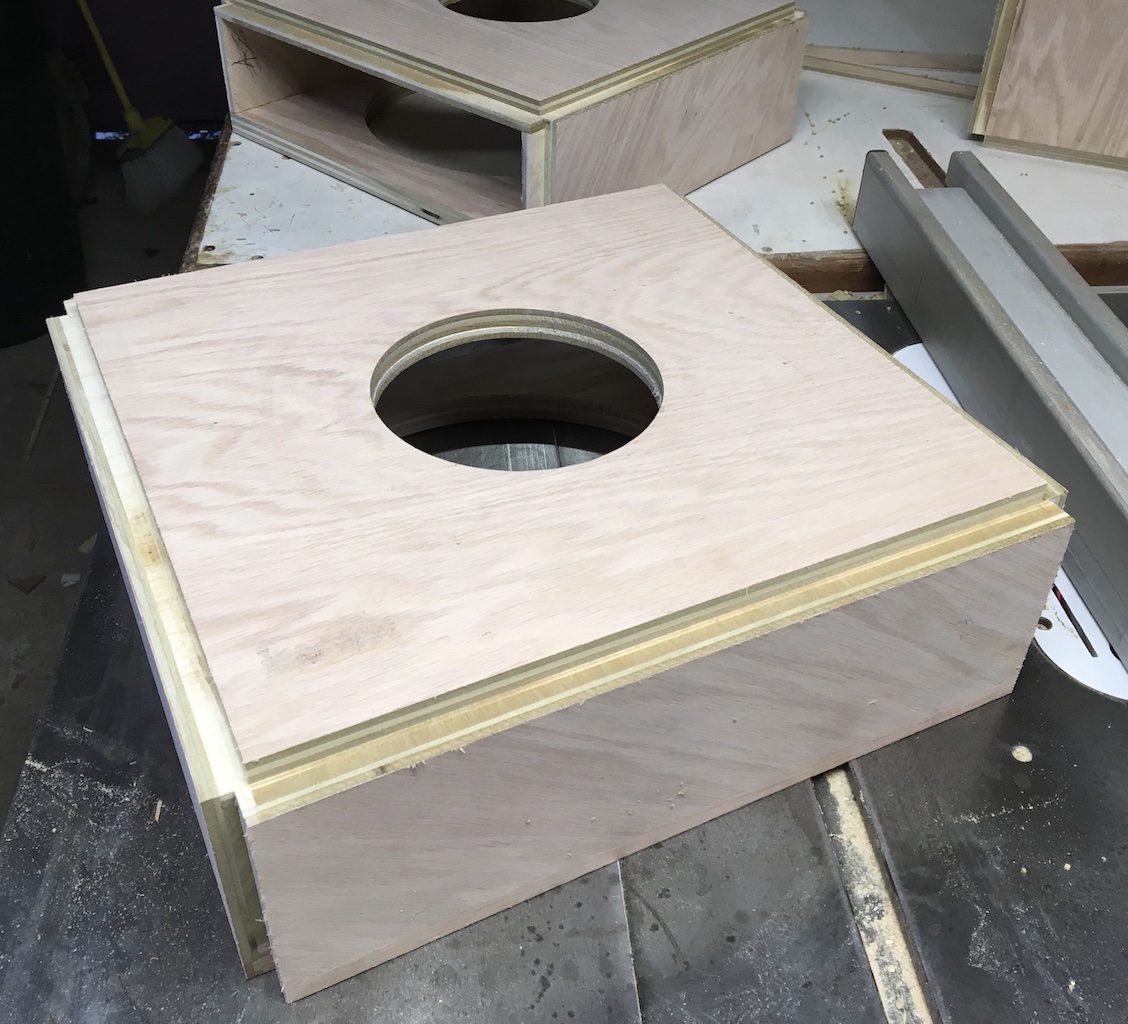

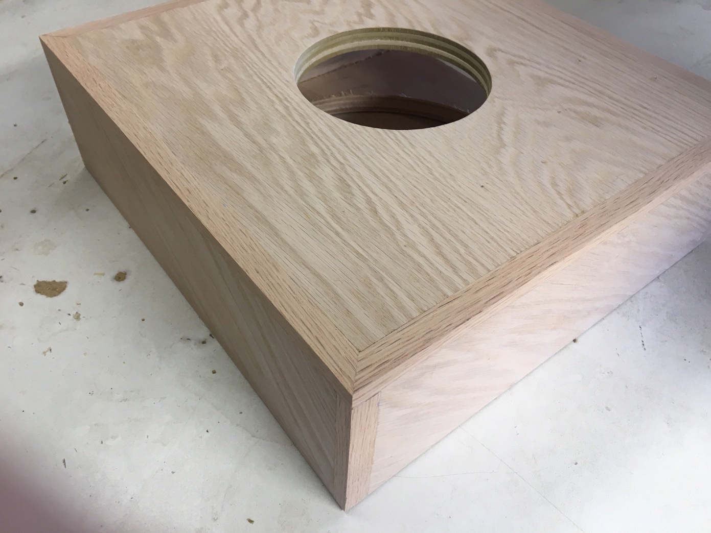

Below: Cab edges were notched on the table saw, to accept the red oak edge members.

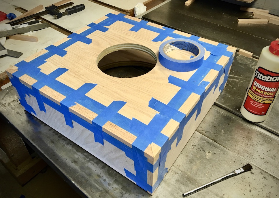

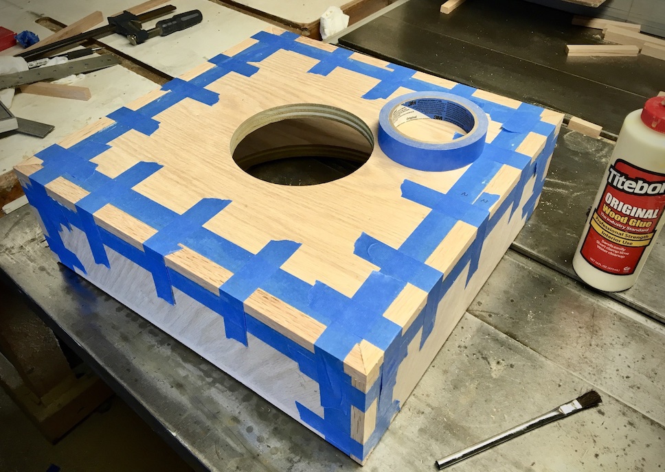

Below: Mitered edge members installed and held in place with painter's tape while the glue sets.
Below: Cab with edge members installed and sanded flush.

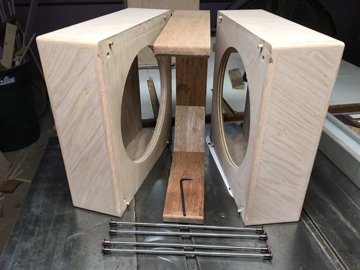

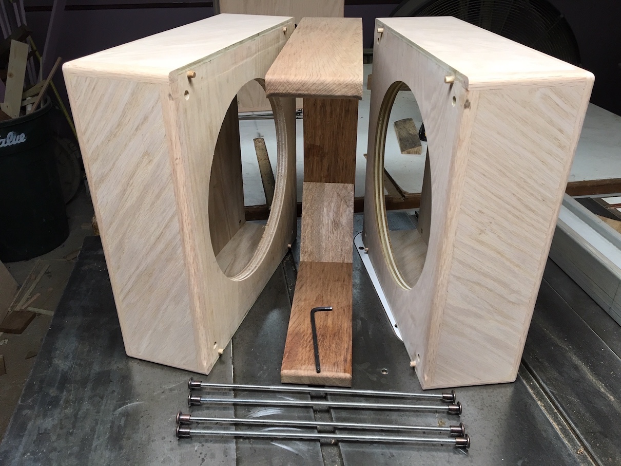

Below: The 3-piece assembly details.

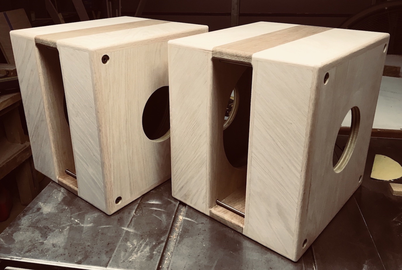

Below: Both subs temporarily assembled and edges rounded over to 3/8 radius on router table.

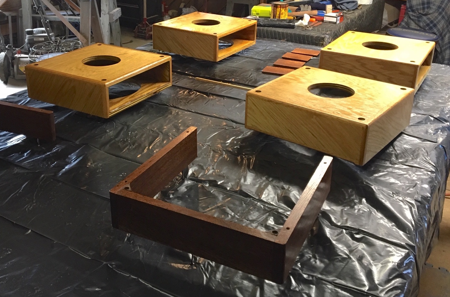

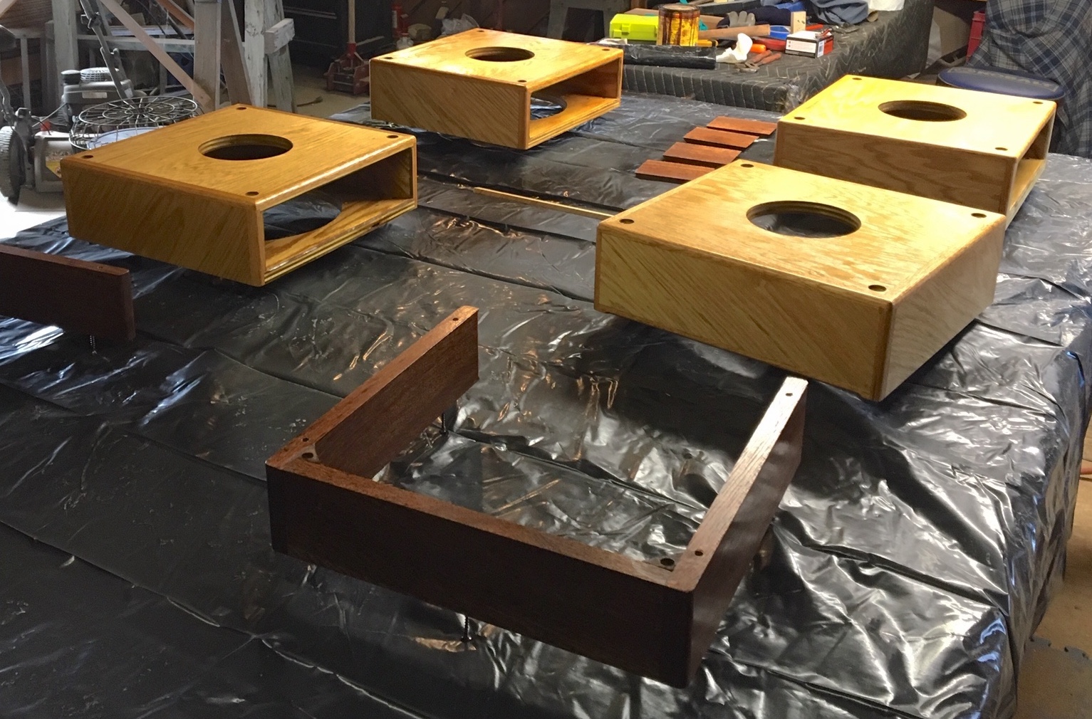

Below: Details stained and spray coated with clear satin polyurethane.

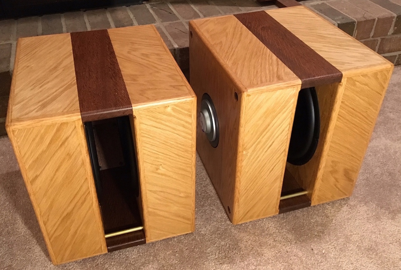

Below: Completed subs with woofers installed.
Below: Back view
