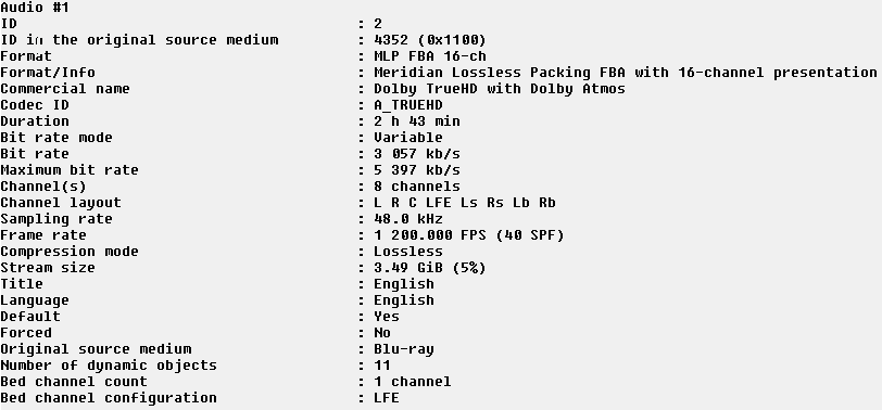

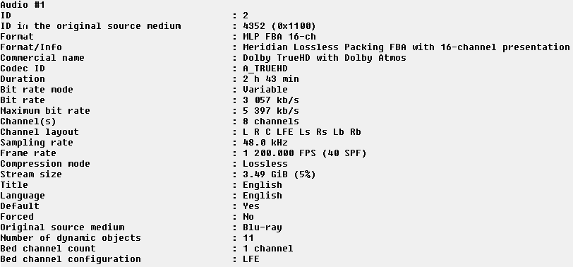

Could be wrong though. I do know that when I rip movies and look at the info, it specifies 16ch of info available. Number of dynamic objects is 11. I'll have to look up exactly what that means.
2022-01-13 18_32_49-MediaArea.net_MediaInfo - Y__ServerFolders_Movies_Finished_No Time to Die ...png
I have no idea, that's why I posted the link to the Dolby page. I would imagine that a lot of Atmos mixes don't use all the available channels, but I had thought they were truly object based so it wouldn't matter what channels the AVR or processor had, atmos would work.
