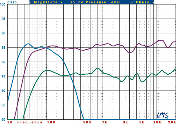

Unless I miss read something, they measured only 85.5 dB on S&V's bench.
I pulled the 88dB from JBL's website.
Disappointing to see they are exaggerating their specifications.

If your jbl 230 is the jbl studio 230, it was reviewed by S&V in 2014:
https://www.soundandvision.com/content/jbl-studio-2-speaker-system-test-bench
Its FR looked very reasonable, but if you listen loud sitting 10-12 ft, then as KEW suggested, set XO to 80-100 Hz (I would say 100 Hz for best result) and forget about the A-S501 as you would end up spending the extra money for no audible gain. The RX-V475 actually has the same vol control/preamp chip as the A-S501 so you do the math..
