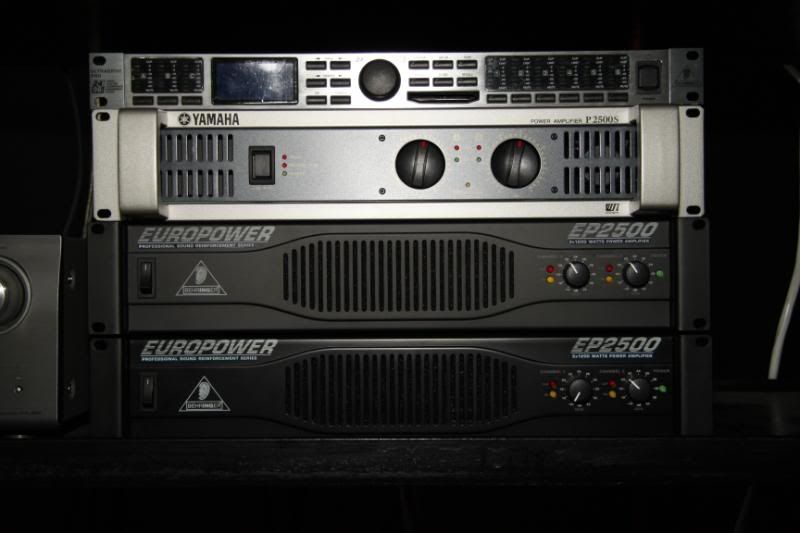

is it okay to stack 2 ep2500 on top of each other or is it to much weight.
