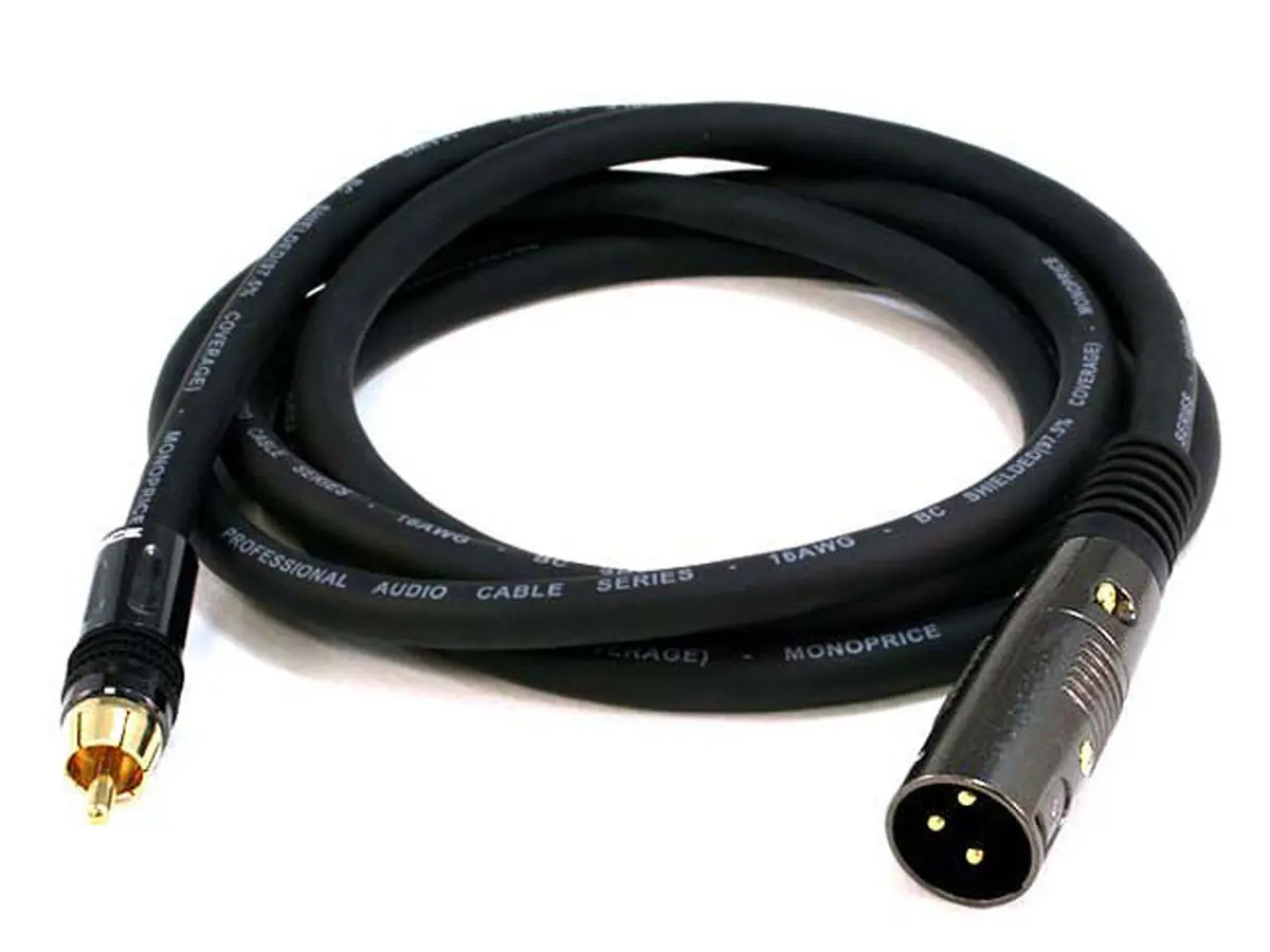

I would get one of the NC502MP based, buckeyamps that come in 2, 4, 6, or 8 channels. Way better than the ATI amp in terms of performance/power output ratios/price ratios.
@DigitalDawn is now a dealer, or you can buy directly from Buckeye Amps - Hypex NCORE and Purifi 1ET400A
He doesn't provide unbalance outputs but a low cost monprice cable will do the job nicely because the Denon can output more than 4 V (I am doing that, no issues).
Awesome! Going to look into that!
