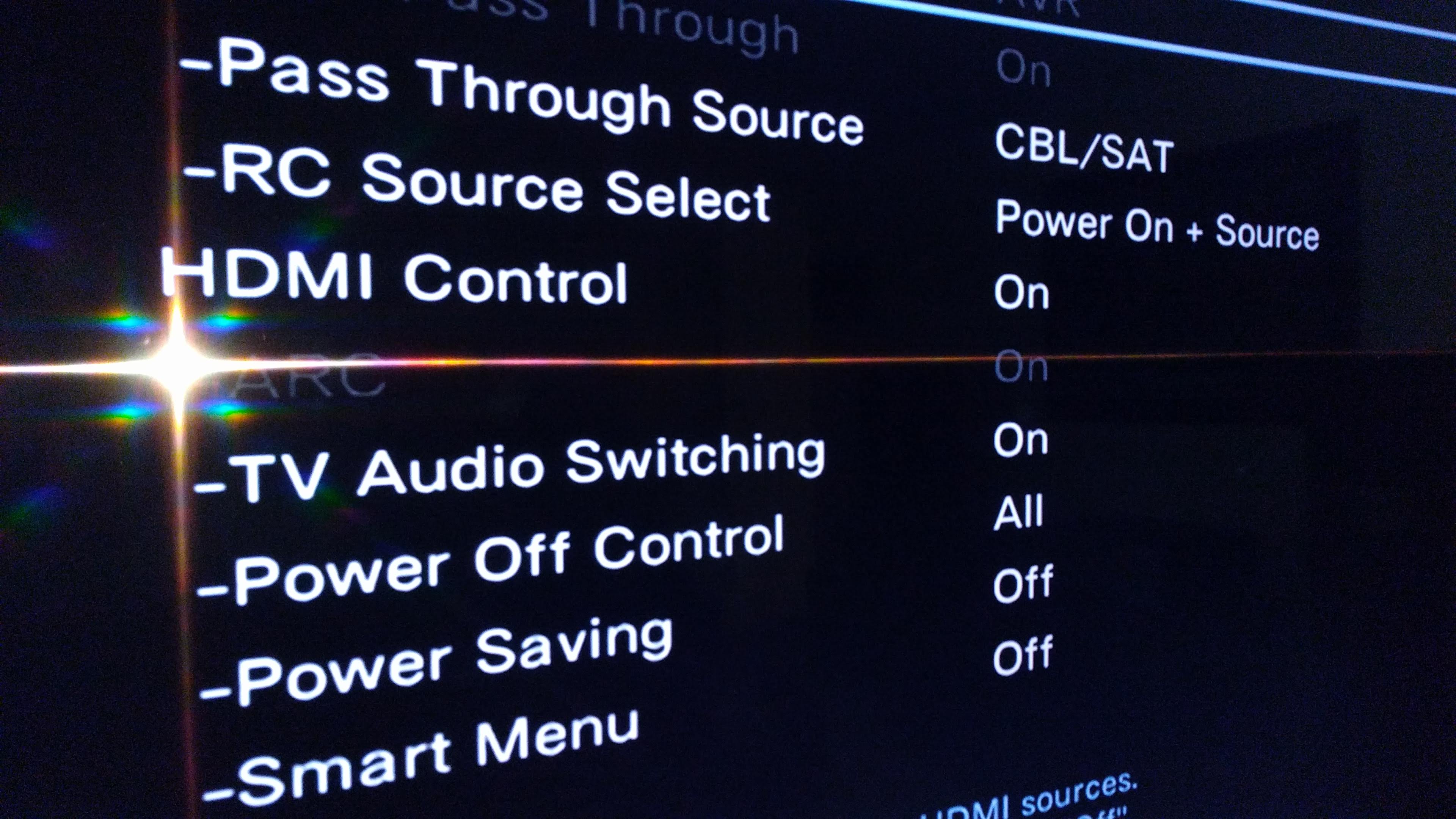

Those are the settings I have on my Denon,my LG is set up correctly.Have not unplugged the TV and Denon yet but will try.
Thanks
