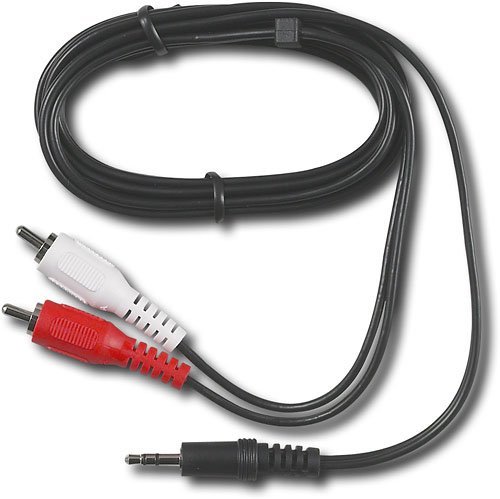

Once I have finalized what I want to build, what else do I need that isn't on this list? What do I need to do to get everything ready to go from let's say an aux cord to my phone?

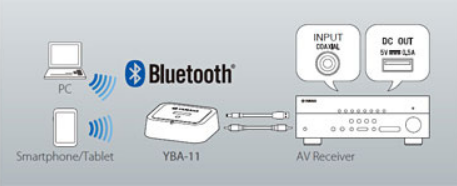

If you have an ipod/iphone, there is a connector on the front of this AVR where you can plug your iphone directly in with the cable that came w/ the phone.
If you have another brand phone, with bluetooth, you can get a YBA-11 wireless bluetooth audio receiver, and plug that into the receiver. Then wirelessly play music from your phone on your system. It also works w/ bluetooth on an iphone.
It is all described on the Yamaha website here:
http://usa.yamaha.com/products/audio-visual/av-receivers-amps/rx/rx-v377_black_u/
